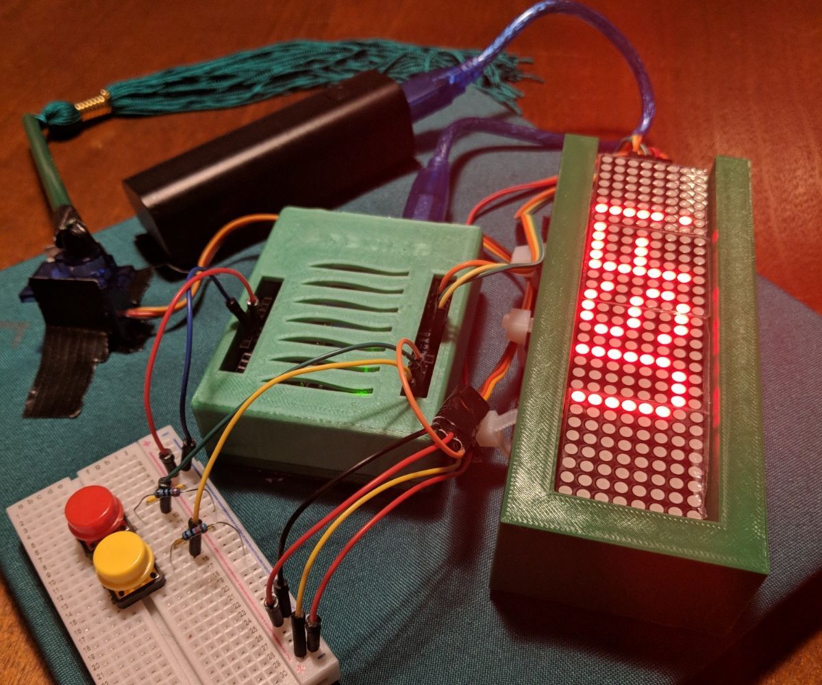

The front wheels are attached directly to the motors, and you need to use a small screw in the motor to make it long enough to fit through the hole in the robot on each side. There should be a small hole in the rotating peg of the motor and you can screw in the screw there and glue the head of the screw into the wheel after pushing the screw through the hole in the box.
The back of my breadboard had a sticky backing, but you can use electrical tape to adhere it if yours does not. Electrical tape was also used for attaching the electrical components not in the board, for safety reasons. The MCU's with the LED displays were attached to the back of the eye sockets using electrical tape and the motors were also attatched to the sides of the box close to the holes using electrical tape. I used red electrical tape to make it more invisible, just in case, and I recommend using an electrical tape with a similar color to your version of ARCA.
The breadboard and pins are set up like this Fritzing image. If you want to add more to this diagram to customize ARCA you can download the Fritzing file in my Github repository and edit it to your heart's content.
I attached the wires to the loops in the gear motors by bending the wires around the loops, to keep them attached. It would probably be a better idea to solder these connections if you have access to soldering iron, but this is an easy solution if you don't have one.
The power pack is attached to the same cord used to connect the Arduino to the computer to download your program, and this is just loose in the robot so it can be easily removed and charged.
