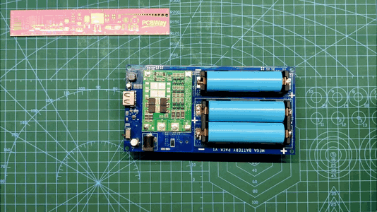

Step 10: Result So Far
After inspecting the overall solder joints and components, I carefully added Li-ion cells to their Cell Holder.
I added them with super caution with the right polarity as if I connected the cells in the wrong polarity, the whole board might catch fire. (BMS will catch fire)
Polarity marking is already added on the PCB so I use it as a reference while adding cells and after this, nothing caught fire.

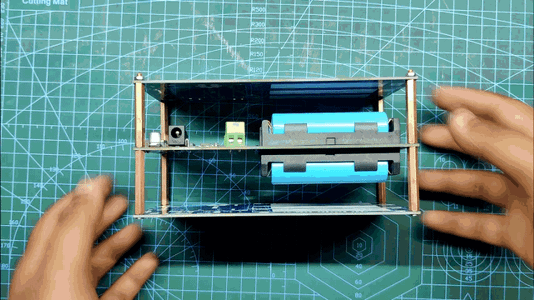

Step 13: Adding PCB Standoffs
To give this board structural strength and a rigid body, I added four PCB Standoffs and connected them with another PCB that doesn't have any componenets.

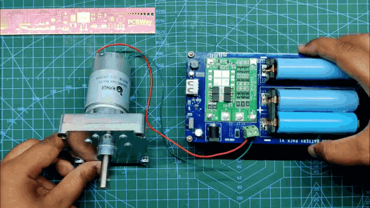

Step 14: Testing Battery Pack Output
After adding standoffs, I used my multimer to check the output voltage of the battery pack which was 11.2V, after checking the voltage, I added a CON2 Connector at the output side so we can add any battery-operated device like a motor for example.
Step 15: Powering a Motor
I used a 12V Gear DC motor for testing this setup, I added its positive and negative wire with the connector, and the battery pack powered the motor without any trouble.

After testing the board, I added another standoff and PCB Layer on the TOP side that makes this PCB a three-layered project, main circuit is in middle and is supported by both sides through standoffs and PCB. kinda like a sandwich, with a pattie in the middle and two bread pieces on both sides.
