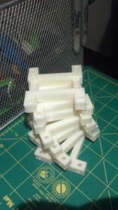

This Instructable details how to build a low cost 4 servo Arduino Uno controlled bipedal robot that is framed with inexpensive 3D printed “I Braces”; that can hold a standard servo and interconnect with additional braces to form various modular structures.

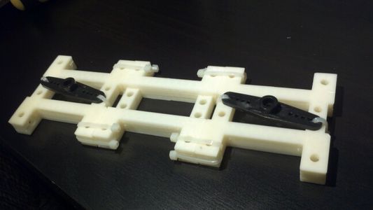

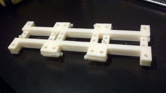

2.       Build frame from braces (make it your own and go custom if you like!)
                                    Bridge (connects legs together)
                                    Left leg
                                    Right leg
                                    Left foot
                                    Right foot

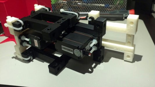

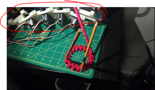

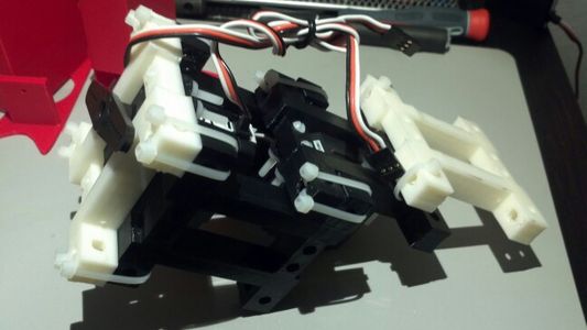

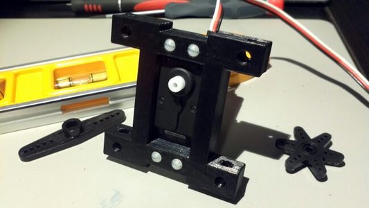

3.       Physically install servos into “I Braces” for both hips and ankles
4.       Connect ankles to legs
5.       Connect legs to bridge
6.       “Harness” servos with a power rail and ground rail (see images)
7.       Install simple 12V rocker toggle (see wiring PDF)

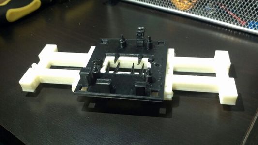

8.       Run servo control wires up through center of bridge
9.       Mount Arduino Protection Plate on center of bridge
10.   Install Arduino Uno into Protection Plate and lock it in
11.   Connect servo control wires to digital pins (see wiring PDF)
12.   Mount Bluetooth modem on bridge (I used a free 3D printed holder design)
