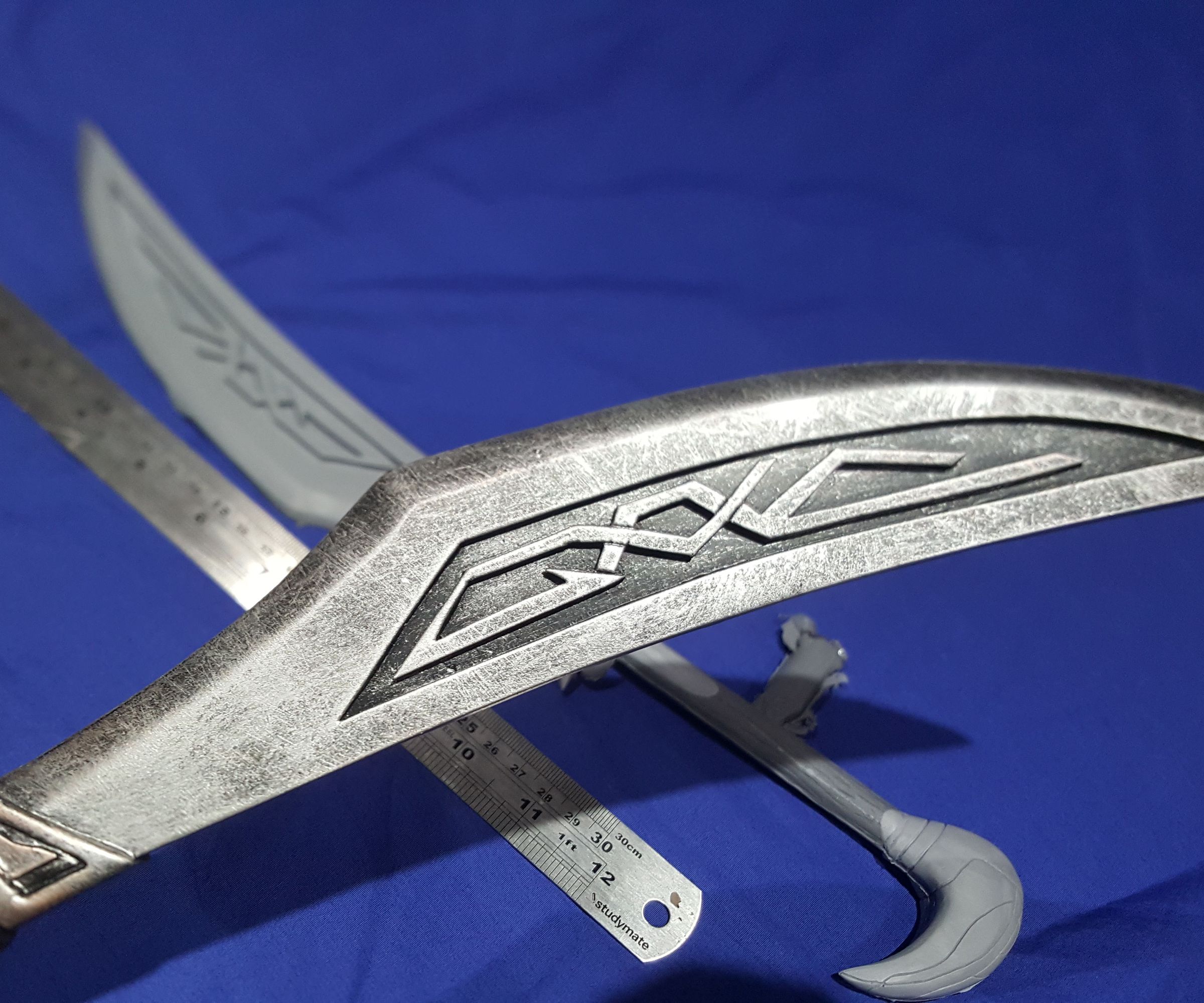

Step 1: References and Templates.
Went onto the Skyrim wiki and saw they had a very nice front on image, so I took that and turned it into a vector outline in Photoshop. It was pretty much an outline of the outside and free handing the inside indent and hilt layers, and I used the wooden dowel as a reference on how large the handle would be to scale the template appropriately (made the handle about 13 cm from the bottom of the hilt to where it meets the pommel, making the whole blade 47 cm tip to tip).
Print that template out and transfer it to the PVC sheeting. I did this multiple times due to 'prototyping' (ie. mistakes, so many mistakes), and found doing the blade and hilt as 1 solid piece works best. Made the blade and hilt 3 layers thick (9 mm), and cut out additional smaller pieces for the hilt details (those wings and layered body, twice for each side). Trim them with a knife so they fit snugly together and glue them down, if you're fast you can used super glue but safer to use a 5 min epoxy or wood glue to nudge them into place.
Eventually you will have a 1/2 of Mehrunes' Razor already 'done'. Time to sand and shape.
Step 2: Sanding, Shaping and Prepping.
Now we need to make the blade more 'bladey', i.e sharp. I traced a guide along the edges for where the edge would stop on the face and in the middle of the 3 blade layers. Then using a rotary tool, hold it on an angle and carefully shape the edges down until they meet the guidelines. Now I found on another project I did just after that if I had left a 'gap' on the blades edge (ie make the face layers thinner along the sides) I could have filled them in with car body filler and sanded them down really easily. So if you don't have a dremel that would be better to do. Once that edge is made, take some sandpaper and smooth it out, going up several grits. Use the dremel to also clean up the sides of the hilt so the multiple sheets are are flush and smooth, with no seam lines.
We also need to prep for some paint and eventual molding, so take some higher grit sand paper (I went 240, 320, 400) and sand every side/face/edge. PVC sheets without prep doesn't take spray paint very well, so roughing it up slightly helps a lot. Hit it with some primer and fill in any imperfections with some filler, while the final product will be aged/damaged it's better to have a clean initial cast to work from. I drilled a hole in the bottom of the hilt so I could spray the whole thing at once by just spinning the drill around, really sped it up.

Step 4: Molding and Casting the Master Copy
Now if you are just doing a personal copy for a cosplay or display piece, you could just paint a primer layer over the whole thing and skip to the final painting step. The PVC sheet is very light and fairly durable, and would work as a personal copy as is. I wanted to sell this thing later as a solid plastic piece to recoup some costs, and to do so I needed a 2 part silicone mold.
I used the monster clay to block out an area surrounding the Razor, and used a clay tool to make sure the clay was joined at 90` angle along the edge. This should allow for a neater seam line and allows the silicone to capture more detail. Take a stick or paint brush and press the end into the clay, making some registration holes so the 2 parts of the mold can 'lock' together later in the correct place. I used some foamcore sheets to build a wall surrounding the clay, sealing the open gaps with some hot glue and more clay. We need a pour spout for the resin, so you can use clay to make it, I glued a thinner dowel piece to the end for that. Once this half is prepared time for silicone.
Pinkysil is a 2 part silicone, pour it by equal volume and using a small amount make a detail coat. This thin layer ensure all details are captured by the mold and allows you to easily get rid of any bubbles that may form are ruin casts. Let that set and keep add more until the whole piece is covered. You can see some blocks of already cured silicone in one image, that was so I could fill some of the volume up with some scrap pieces, as silicone is very expensive (so expensive, ugh...). Let that cure, flip it over and very carefully remove all the clay on the other side without removing the master piece, you may need to wash it with soapy water depending on your material. Reset the walls of the mold and apply your mold release. Silicone will stick to itself, so the mold release makes a thin layer of material to prevent this. I smeared petroleum jelly across all of the silicone, cleaning anything that stuck to the prop, but a spray on one would have been much easier. Repeat the previous steps, let that set, peel it apart and remove the master copy, and now you have a reusable mold. Take something rigid (like the PVC sheet) and cut out some pieces to sandwich around the mold so they stay together when casting.
Casting this was fairly simply as my mold was self-releasing from resin. Yours may need a releasing agent for every cast, check just in case. Keep the mold open for now and mix up a small amount of resin. EasyCast is a 2 part mixture by equal volumes, so I mixed up some small batches and poured them into places where air could get caught if I did 1 single pout (the tips of the hilt edges and along the rings of the handle). This stuff cures very fast, so I left it for 10 minutes and stuck both silicone pieces together and secured them together with rubber bands and clamps. Mix up a larger batch and pour that through the spout, making sure to move the mold around to let lose any bubbles and make sure the resin gets everywhere. Let that cure for a hour or so and you can remove you own plastic Daedric Artefact!
