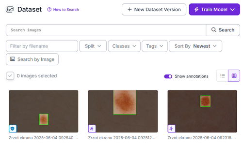

Step 1: Data Collection
Collect images of skin lesions from open databases like ISIC (https://gallery.isic-archive.com/#!/topWithHeader/onlyHeaderTop/gallery?filter=%5B%5D).
Ensure each image is labeled.
You can use tools like Roboflow to organize, annotate and split your dataset into training, validation and test set.
Export dataset in YOLO format.
