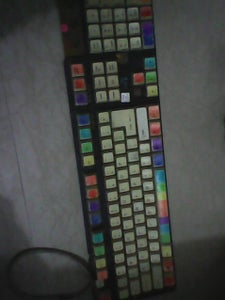

First Of All We Need An Old Keyboard...(Basically We Used An Old Keyboard With A Big Chip For All Keys Not Like Of Todays That Have Plastic sheets...)

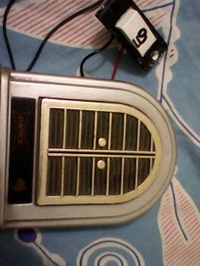

  • An old Musical Multi Tone Bell..With Dc Input And Wired One..(www.1800doorbell.com)

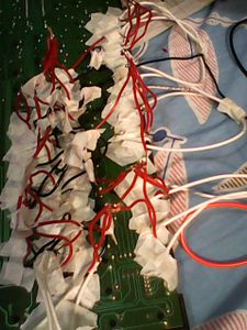

The Key Of Keyboard Are Basically Switches That Complete Connection...
A Key Have Two wire Slots Just Like A Switch They Don't Have Any - + Just Solder On Any One Of Them...

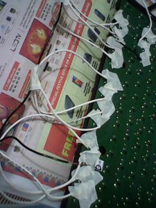

Solder Red Wires First...To Any Point Of the Keys From The two...
Then Solder The Black wire To The Other One..

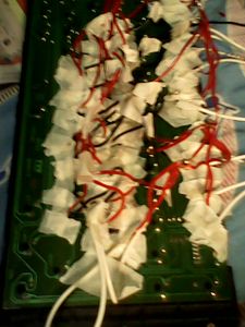

Solder All wires To The Keyboard From keys/switches..
Usually There Are Two Wires Solder all Black Wires To Negative And Red To Positive..
Remember All Connections Should Be In Parallel..
and One More Important Thing U Should Be An Expert In Soldering...

Add a switch to the bell where the cell are put
