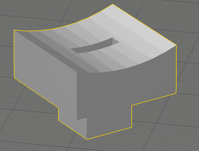

OPTIONAL - If you want the light to shine through the letters you can 3D model key caps that have hollow letters as seen above.

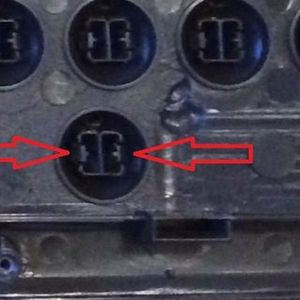

After your keyboard is disassembled you need to remove all of the key caps from the front fascia. Mine were removed by squeezing the two tabs on the underside of the keys (marked by the red arrows) and popping them out. Once all of the keys are removed you can start drilling holes to allow the light to shine through. I used the smallest drill bit in my set and really you can use whatever size drill bit you want. Just remember not to pick a drill bit so big that you drill through the key stem. Also remember that the bigger the drill bit, the more light is going to be present. Here you can see I’m drilling the holes through the underside of each plastic key-domes. After each of the key-domes has a hole your front fascia should look like this.

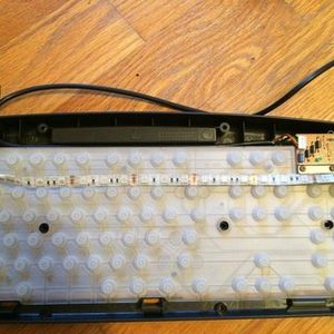

After this you can move to the bottom half of the keyboard which contains the rubber sheet. As you can see the wire feeds into the keyboard through this little rubber block marked by the red arrow. You should be able to lift the little block out of its crevice like I did here. After the block is out you need to drill a hole for the LED wires. I recommend choosing the largest drill bit to give your wires the most room. When you drill the hole make sure it punches through the top of the block so that the the wires can be placed down in the hole. This is necessary because the connector for the wire is too large to thread through the hole; this means that the wires must be placed in the hole and not threaded through. After the hole is drilled you can place the block back into its position.
Step 5: Assembling the LEDS
Now we can begin assembling the LEDs in the keyboard. First, decide how you want to run the LEDs. I decided to take the simple route and run one short strip across the top. This made my top keys slightly brighter than my bottom keys, to fix that you would just bend the strip around and do a run on the bottom. Make sure to take note of where the connector is for the LEDs. It needs to be able to extend through the little block as seen here. Also make sure the LEDs don’t interfere with the rubber domes. After you have decided where you want your LEDs you can start gluing. I started from the top of the strip and worked my way down gluing about an inch at a time as I went. After your LEDs are in place you can move on to final assembly.
