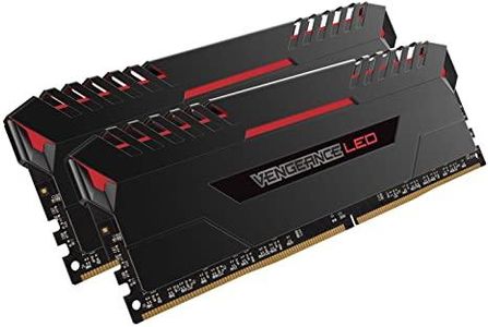

Memory has two major factors that determine its performance. First, it has a capacity. Capacity determines how much information can be stored in the memory at a time. For example, two 8 GB sticks of RAM (memory) have a total capacity of 16 GB, so 16 GB of data can be stored in the memory at any given time and then sent to the CPU. The more capacity the memory has, the more data in can send to the CPU at a time. The other factor is its frequency. A higher frequency memory can retrieve and send its capacity (or less) of data from the storage device to the CPU. More capacity can be acquired by adding more memory to your computer, while more frequency can only be added by replacing the memory that you are using with newer versions.

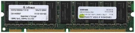

The first actual computer memory used in computers was developed in 1983 and was called SIMM (single in-line memory module). This RAM was the starting point in the development of future memory that would become more and more powerful. This memory is no longer used because it can only hold 4 MB of space, whereas modern memory can hold several GB.
The next major breakthrough in memory was the development of SDRAM (synchronous DRAM) in 1993. What made this memory so revolutionary was its ability to sync itself with the computer system's clock, making it much faster than any of its predecessors. Even though this was a great improvement, one more major improvement was made to the memory we use today, so this kind of memory is only used in very old computers.

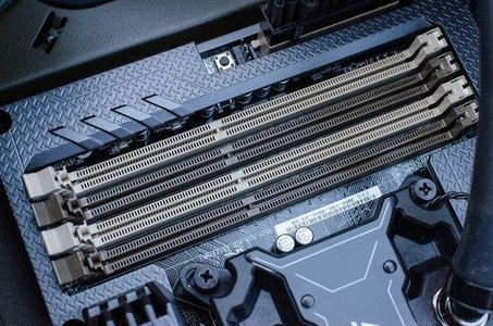

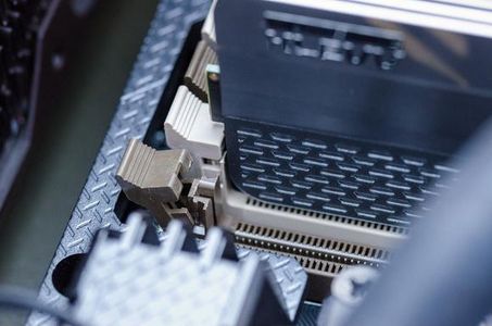

To remove old memory and install newer, better memory, make sure that the computer is off and that all cables connected to it are unplugged. Then, remove the side of your case so that you can get at your motherboard. The RAM slots are next to CPU socket; you can find it by looking for the big heat sink on the motherboard. To remove the old memory, push the plastic retention clips outward so that you are able to take out the old sticks. Before putting the new memory in the motherboard, make sure to match the notch in the bottom edge of the RAM with the memory slot. Make sure to read your motherboard's manual to make sure you are filling up the RAM slots in the correct order if you are not using all of them. Once you have put the new stick in the right slot, push the retention levers back inward so they lock the new sticks into place. After that, all you have to do is plug everything in again, put the side of the case back on, and turn on your computer.

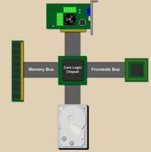

Step 5: Memory Architecture
In a stick of memory, there are several parts that make it be able to do what it does. Most memory has several storage mediums called "banks". Each bank has something called a virtual plane, which basically is what is activated by electricity and allows the memory from the bank to be sent. Each stick of memory also has small memory chips on it which allow it to control which information is being sent to the processor at a specific time. Memory capacity is determined by how many chips can be stacked on the processor chip in the memory stick. Finally, the memory is connected to the CPU by a front side bus (FSB) so that it can actually send the data to the processor.

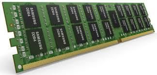

One form factor of memory is a DIMM (dual in-line memory module) that supports many types of memory used today, especially memory used in PC towers. It uses a 64-bit data path, which is the fastest data path in use today. DIMM memory is a universal memory type used in anything from computers to printers.
