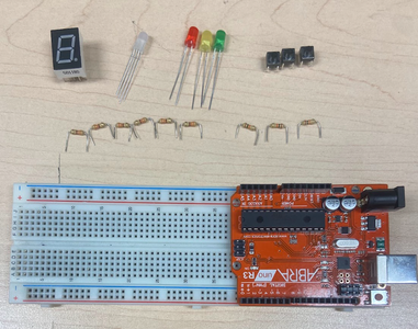

  1. Arduino x 1
  2. Breadboard x 1
  3. Push Buttons x 3
  4. LEDs x 3 (Red, Green, Yellow)
  5. RGB LED x 1(Common Cathode)
  6. 330Ω Resistors x 6
  7. 10kΩ Resistors x 3
  8. 7 Segment display x 1(Common Anode)
  9. Wires (as required)

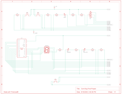

Step 1: Components

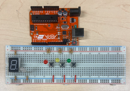

Place the push buttons onto the breadboard bridged over the central gap. Connect one leg of each button to the GND rail using a 10kΩ resistor. Connect the other leg of each button to the power rail.
Place the LEDs onto the breadboard next to a corresponding button. Connect the negative legs of each LED to GND rail using a 330Ω resistor. Also place the RGB LED onto the breadboard and connect its cathode (longest) leg to Power rail using a 330Ω resistor.
Place the 7 segment display onto the breadboard bridged over the central gap. Connect both common (middle pins) to the Power rail using 330Ω resistors.

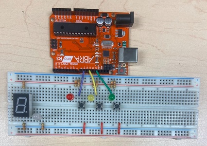

Connect (Image 1)
  1. the green button leg, connected to the resistor, to Pin 13
  2. the yellow button leg to Pin 11
  3. the red button leg to Pin 9

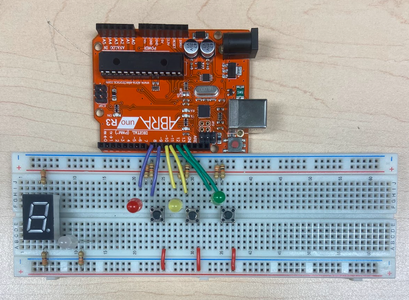

Connect (Image 2)
  1. the green LED's positive (longer) leg to Pin 12
  2. the yellow LED's positive (longer) leg to Pin 10
  3. the red LED's positive (longer) leg to Pin 8
Connect (Image 3)
  1. the green leg (outermost) to Pin ~6
  2. the blue leg (middle / next to cathode) to Pin ~5 and
  3. the red leg (other side of cathode) to Pin ~3
*RGB LED works best with PWM (~) Pins
Step 3: Connections Cont.

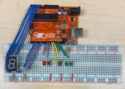

Connect (Image 1)
  1. 'C' (4th leg on bottom) to Pin 2,
  2. 'D' (2th leg on bottom) to Pin A5
  3. 'E' (1th leg on bottom) to Pin A4
  4. 'G' (1th leg on top) to Pin A3
  5. 'F' (2th leg on top) to Pin A2
  6. 'A' (4th leg on top) to Pin A1
  7. 'B' (5th leg on top) to Pin A0

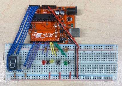

Finally, connect the GND rail to GND Pin and the Power rail to 5V Pin. Also connect the other side of the breadboard with wires to allow power and GND there as well. (Image 2)
*Reminder - All of these components (buttons, LEDs, RGB LED, 7-segment display, etc.) can be connected to any of the Arduino pins, Just make sure to update the pin numbers in your code to match your wiring.

Step 6: Schematic View
