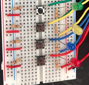

Step 2: Wiring the Colored LEDs and Push Buttons
Place the four colored LEDs — red, green, blue, and yellow — onto the breadboard spaced out evenly for wiring convenience. Connect the anode (longer leg) of each LED through a 330Ω resistor to the Arduino’s designated digital output pins: red LED to pin 13, green LED to pin 7, blue LED to pin 11, and yellow LED to pin 9. Connect all the cathodes (shorter legs) of the LEDs to the breadboard’s ground rail.
Now, set up the push buttons. Insert each push button so that it straddles the middle gap of the breadboard, ensuring two legs are on one side and two legs on the other. For each button, connect one leg on the first side directly to the Arduino digital input pin assigned for that button: red button to pin 12, green button to pin 4, blue button to pin 10, and yellow button to pin 8. The opposite leg of each push button should be connected to the breadboard’s +5V power rail.
To prevent the Arduino input pins from floating (which could cause unpredictable readings), connect a 10kΩ resistor from each Arduino input pin to ground. This pull-down resistor ensures that when the button is not pressed, the input pin reads a stable LOW signal. When the button is pressed, it closes the circuit between +5V and the input pin, causing the Arduino to read a HIGH signal.
This wiring means each button press results in a HIGH input reading, and releasing the button returns it to LOW. This straightforward setup simplifies the logic in your Arduino code.

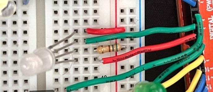

Step 3: Wiring the Common Anode RGB LED and Piezo Buzzer
Next, place the common anode RGB LED on the breadboard. For this LED type, the common pin (anode) connects to +5V power on the breadboard.
Then, connect each color cathode through a 560Ω resistor to Arduino digital output pins that will control the colors. Connect the red cathode through a resistor to pin 6 and the green cathode through a resistor to pin 5. Since this is a common anode LED, the colors will light up when their respective pins are set to LOW by the Arduino (this is because the current flows from +5V through the LED cathode pins to ground).
The blue pin of the RGB LED should also be connected directly to ground if it is unused in your code.

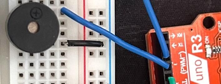

Finally, connect the piezo buzzer’s positive terminal to Arduino pin 3 and its negative terminal to ground. The buzzer will provide audible feedback for game events such as button presses, mistakes, and wins.

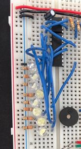

Step 4: Building the 8-LED Line Chaser Circuit With 555 Timer and 4017 Decade Counter
To create the animated LED chaser feature of your Arduino memory game, we will build a simple yet powerful line chaser circuit using a 555 timer IC and a CD4017 decade counter IC, controlling 8 white LEDs in a smooth, sequential pattern. Begin by placing the 555 timer on your breadboard with the notch or dot facing left, which helps correctly identify the pinout layout.
Now begin the wiring:
  1. Connect pin 1 of the 555 timer to GND (the ground rail) and pin 8 to +5V.
  2. Join pins 2 and 6 with a jumper wire, and also connect pin 4 to pin 8 (this disables the reset pin so the timer runs continuously).
  3. Place a 1μF capacitor on the board: its negative leg goes to pin 1, and its positive leg to pin 2.
  4. Place a 1kΩ resistor between pin 7 and pin 8, and a 47kΩ resistor between pins 6 and 7.
These components form an astable multivibrator configuration, which causes the 555 timer to output a steady square wave (clock signal) on pin 3, the output pin.
Next, place the CD4017 decade counter on the breadboard, again with the notch facing left. Wire pin 16 to +5V, and pin 8 to GND. Connect both pin 13 (disable) and pin 15 (reset) to GND to ensure continuous counting without interference or resets.
Using a jumper wire, connect pin 3 (the output of the 555 timer) to pin 14 of the 4017 — this is the clock input, which will trigger the IC to cycle through its outputs sequentially. Each clock pulse from the timer advances the "high" output to the next pin on the 4017 IC.
Now, wire up your 8 LEDs to the 4017’s first 8 output pins. These will light up one at a time in a continuous loop, giving the iconic chasing effect. The pin mapping for your 8 LEDs is:
  1. LED 1 → pin 3
  2. LED 2 → pin 2
  3. LED 3 → pin 4
  4. LED 4 → pin 7
  5. LED 5 → pin 10
  6. LED 6 → pin 1
  7. LED 7 → pin 5
  8. LED 8 → pin 6
Connect each LED’s anode (long leg) to one of these output pins. Then connect each cathode (short leg) to GND through a 470Ω resistor. You can use a shared negative rail and place the resistors either inline before the GND connection or directly between each LED and the ground rail.
Note: We are only using 8 outputs of the 4017 (even though it can go up to 10). To make the sequence loop after the 8th LED, you must connect pin 9 (Q8) to pin 15 (reset) using a jumper wire. This way, the 4017 resets itself once it reaches the 9th output, effectively limiting the cycle to 8 LEDs.
Once you’ve completed these steps, power the circuit using the 5V and GND pins from your Arduino. The LEDs should begin to “chase” in a loop, with the speed determined by the 555 timer’s resistor and capacitor values. If you want to fine-tune the speed later, you can replace the 47kΩ resistor with a 100kΩ potentiometer, allowing you to adjust the chase rate dynamically.
