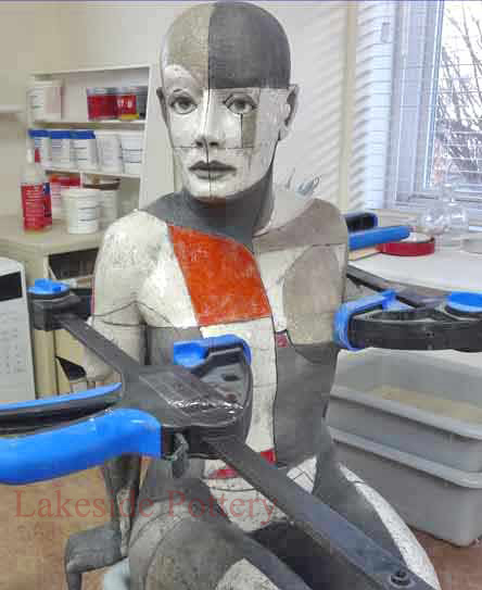

Step 6: Using Clay for Securing Attached Pieces in Place During Curing Duration
If pieces do not hold well using gravity, use clay for additional support.
Let the epoxy cure for 60 or more minutes before removing excess cured epoxy with a blade.
