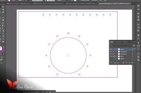

Step 1: 🖥️ Setting Up the Base Design
I used Illustrator to create the shapes and layers of the frame. I started by defining the outer dimensions, the motor’s center point, and holes for the threads.

Step 4: 🛠️ Functional Cutouts
I designed the cutouts for the battery box, motor, wiring, and switch in the appropriate layers.
Step 5: 🌈Color-Coding Layers
I assigned different colors to each layer to study how they interact and ensure everything aligned correctly.
Step 6: 📁Preparing Files for Laser Cutting
I created two files: one for cutting 4mm thick industrial cardboard, and another for thinner cardboard. I added corner tabs and borders to increase depth between layers.

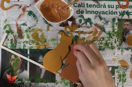

Step 12: Coloring Browns
I used various brown tones for the violin, branches, cats, and their tails.

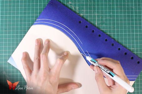

Step 20: 🖊️Drawing Wind Waves
I drew a curved line on cardboard as a guide for the wind lines, then traced it onto the sky layer using a white permanent marker.

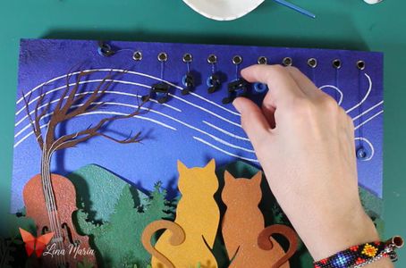

Step 30: 🧵Threading the Notes
I took pairs of washers and tied them together using a thread. Then, I passed each thread through one of the top holes on the sky layer (where I had installed the eyelets), and continued threading it through one of the smaller holes surrounding the large central circle on the next layer.
Step 31: Tying All Threads to the Ring
I pulled all the threads tight so that the washers sat snugly against the eyelets on the sky layer. With the threads grouped together, I found the central point where they all met naturally. To that distance, I added the space between the motor’s axis and the loop on the bearing. That gave me the exact spot where I needed to tie a knot, securing all the threads tightly to the metal loop I had embedded in the small 3D-printed piece inside the bearing.
Step 32: ✅ Motion Test
I turned on the motor... and it worked! The washers moved in a beautiful wave as imagined.
Step 33: 🎶 Touches With Notes
I glued the musical notes onto the washers and also some onto the branches.
