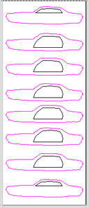

Step 2: Create the Outline in VCarve
Sketch ideas in a notebook on what you would like the car to look like. We then found an outline of a 1970 mercury cougar. . This outline helped us create the part in VCarve Pro. We found this outline of the car on https://photovault.com/184829 website. We then scaled the drawing to 10.75 inches long and it is 2.88 inches high. After figuring out the dimensions of the car, we then put the outline into VCarve and scaled it to the right size.
Step 3: Find a Piece of Wood Suitable for the Project.
We decided that we would need multiple pieces of wood that had to be the exact same depth as to use the same VCarve Pro program for each piece of wood. This would have been a small challenge for us as we would've had to measure all the pieces of wood we had in our inventory. We decided it would be smarter to take a large piece of wood and be able to cut multiple car outlines and know that all of them would be the same width.
Step 4: Creating the Milling in VCarve Pro.
Then we went back into VCarve and simulated the whole bitmap to make sure that none of the outlines would touch each other and none of the outlines would be outside of the wood we are using.
Step 5: Create Windows and Inside of the Vehicle.
First we had to figure out what shape we wanted the windows. But we also had to put into consideration that we wanted to put seats in the car and also a dash. This meant that we could not just put a window on every outline because then inside would not be hollow, meaning we couldn't put the seat in. So then we decided that we needed the two outer most pieces to have the windows and then the other ones would have to be bigger so that we could put the seats in.
