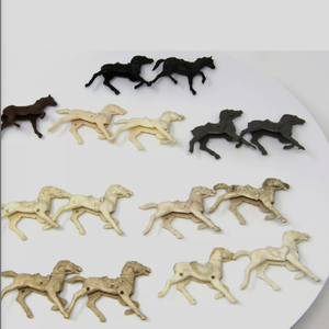

First thing I need to do was find some horses I found some vintage TUDOR ROSE horses online that fitted the stile and size I was looking for which are 1/30 scale. Next I cut a circle of cross ply out with my scroll saw spacing the horses out on this I was happy with the size and carried making more parts at a similar scale.
Step 2: Building a Basic Structure and a Bit of Painting
The Vintage horses were hollow so I filled these with epoxy resin so that they could be drilled at a later stage for the poles to be put through the horses. I used my drill to hold the dowel in and place that against my abrasive wheel to achieve the shape. I then cut out some more pieces of wood, glued them together with the epoxy resin and then applied some paint.
