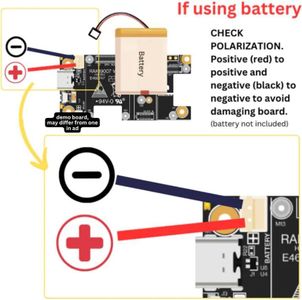

Solder JST connector to battery holder tabs
  1. Pay attention to polarity on RAK board (see image, this came as a little card in the box with the WisBlock). I had to solder the black wire to the positive tab and the red wire to the negative tab. You could also switch the wire leads in the connector instead, but it didn't really bother me enough to do that this time.
