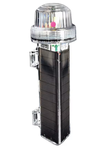

Introduction: Meshtastic Solar Buoy
This Instructable shows how to repurpose an inexpensive solar anchor buoy light to build an extremely durable and waterproof solar powered Meshtastic node. I've included #affiliatelinks to the supplies and tools that I have personally used, so you can help me buy stuff for future how-to Meshtastic projects š
#AliExpressPartner #AmazonPartner #eBayPartner
The 6V solar panels, 18650 battery, and waterproof case work great when paired with a RAK 19003 WisBlock Meshtastic starter kit.
My original prototype has been living its best life 80 feet up in a tall tree since August 2024. So far it has proven to be extremely reliable with range only limited by line of sight!

Your buoy will come sealed TIGHT from the factory for its original mission to survive in the open ocean.
Fortunately RTV silicone is no match for a big wrench. Congratulations on completing the most physically demanding step of this project.

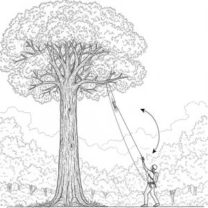

Step 12: Hoist It Up a Tree!
There are any number of techniques to SAFELY run a throw line up and over a high branch of a tree to elevate your node. I've read about people using drones, air cannons, even casting it with a fishing pole! Personally I've had success using a giant sling shot to reach 80+ feet elevation. Preparing for a clean shot is the best method for success.
1) Lay your line out on the ground under your tree in big long rows zig zagging back and forth. Be careful to avoid sticks or plants that may snag your line as it shoots up.
2) Attach an 8oz throw bag to the leading end of your line and a second throw bag to the trailing end.
3) Nestle the 8oz throw bag into the slingshot basket and take aim at your target. I've found that a 60 degree vertical angle (steeper than 45 degrees) yields good penetration into a tree's canopy without overshooting into neighboring trees.
4) If you miss, drag the line back down and start over with with a clean lay of line.
5) Once you hit your mark, pull the line back towards you until the leading throw bag is up near your apex. Slowly release the line and maneuver it down to the ground as vertically as possible through the underlying branches.
6) Now switch sides and pull the trailing bag up towards the apex. Lower it back down as vertically as you can.
7) Remove both throw bags. Tie each end of the line to one of the lugs of your solar buoy. I like to use a taut-line hitch knot because it doesn't bind up under tension, which makes it easier to remove in the future.
NOTE: For RF performance it doesn't matter it the antenna points up or down. I like to point the antenna up so it hits fewer snags when I eventually lower it in the future.
8) Pull on your line to raise the buoy up into the tree canopy.
9) When you have reached your desired height, tie the loop around the trunk of the tree. I don't recommend using a ground stake or nearby objects unless you are very confident they are permanently anchored. When the wind blows and the tree sways, the tension on the loop could pull objects out of the ground and create a safety hazard swinging in the wind.
10) To bring the buoy down, simply untie the loop from your tree trunk and pull.
