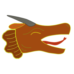

Step 4: The Head
Now for the last part of the dragon - the head. Rather than trying to create the head using only Javascript (which would be a nightmare), I opted to create it using a paint app. Most computers come with one automatically installed, but you can also find some great online ones (which is where I created the head). If you don't want to make your own, you can just use the one I have here.
