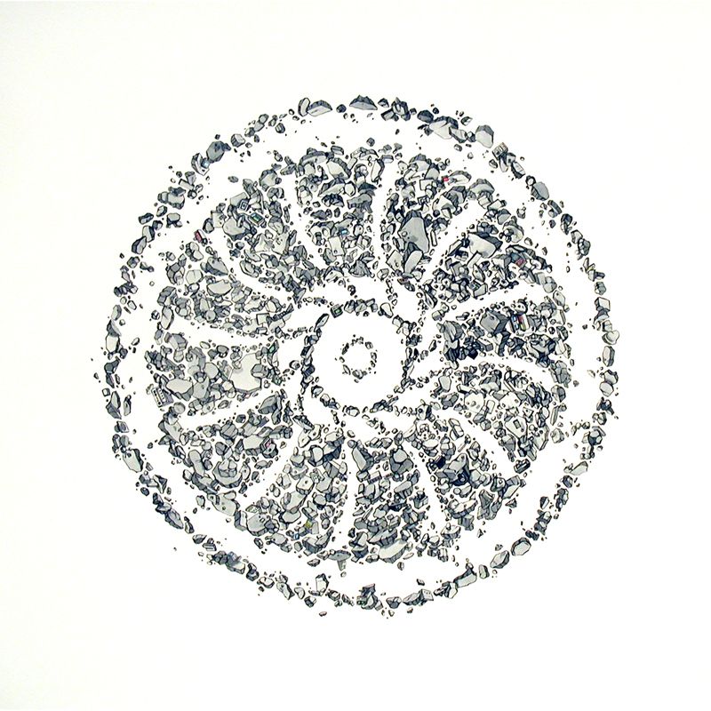

Step 3: Establish a Feedback Loop
Now that everything is plugged in and turned on, you should be seeing some sort of image on the screen. In the first picture you can see that the monitor is displaying images of itself in increasingly smaller increments. This is video feedback. Experiment with the zoom controls on the camera (generally W T for "wide" and "tight" on camcorders) or move the tripod closer to or further from the monitor. In fact, this is a good time to play around with different distances and angles to see what happens. You can also adjust the brightness or contrast to get something close to what you see in the first image.
If you're not seeing an image, make sure that the lens cap is removed and that the brightness, contrast, etc. controls on the monitor and camera are all set to their default positions. If you still aren't seeing anything, double check that cable is plugged into the proper ins and outs, and that the appropriate input is selected on the monitor. If the image is dim, turn up the brightness or contrast on the monitor. If you are seeing scan lines (like in the embedded videos), try adjusting the exposure level on the camera.
Step 4: Add a Twist and Find Your Center
Now that you've established a feedback loop, tilt the camera about 20 degrees to the left. You will notice that the image on the screen is tilted at the same angle, but in the opposite direction, and that all of the subsequent images are rotated again by that same angle. At this point, play with the zoom/distance and the angle of the camera to see what happens.
Now it's time to center the image on the screen by adjusting the height and left/right position of the tripod. This is probably the trickiest part of the whole process, as everything you see on the screen is reversed. It's kind of like trying to play a video game with the controller held upside down. Be patient and move slowly in small increments. It will still work even if it is not perfectly centered in the middle of the screen.
Once you're more or less centered, you should be able to get something like the third image here. The bright dot that is spiraling into the center is actually the reflection of a light bulb on the screen. Try zooming in and out to see what happens. I like to have something close to a 1:1 zoom ratio.
Step 5: Dialing In
At this point the setup of the system is complete, and all that remains is the fine tuning.
As I said in the intro, you will ideally have a monitor with dedicated brightness and contrast control knobs. Experiment with these levels until you find a balanced, stable image. If you find that the image on screen is disappearing, try introducing a light source in the background to reflect off of the screen and continuously "seed" the feedback loop. My monitor also has Tint and Color knobs, which can have some pretty stunning effects. Play around with whatever controls you have available, but start out testing one at a time so that you don't get too far from your baseline image.
This is the part that is most difficult to explain; the results and methods will vary depending on your particular equipment and conditions. Take your time and enjoy figuring out what effect all of the different parameters have on the image. When you find a nice stable loop, sit back and enjoy it for a while.
