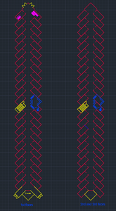

Step 8: First Sketch
My first complete sketch, made in Autodesk AutoCAD that included the building as well as the essential surroundings.
Here are some noteworthy details:
  1. Rooms: A total of 254 rooms, with 127 in each building; 41 on the 1st floor, and 43 on the 2nd and 3rd floors
  2. Parkings: A total of 396 parkings, with each building having 198
  3. Road: A road surrounds the building to help access parking and exits
  4. Exits: 2 exits in the front and back, as well as one in the side of the building
  5. Elevator: Features 1 elevator as well as a staircase, in compliance with fire exit guidelines (see doc below)
  6. Laundry: A necessary amenity that is featured on each floor, with each room having 3 washers and 3 dryers
  7. Apartment lobby and leasing offices: Found on the ground floor, at the main entrance

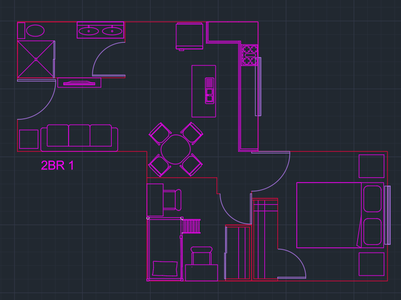

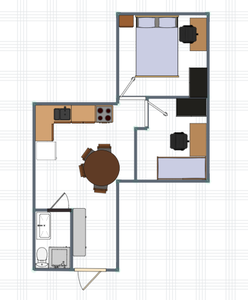

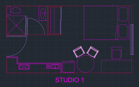

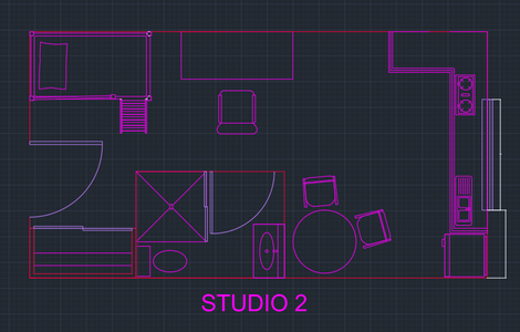

Step 10: Room Spacing and Layout
I made use of Planner 5D, a free online tool, as well as Autodesk AutoCAD to visualize the apartments that would make up Mesquite Park Apartments. I started by creating the rooms in AutoCAD, which I furnished with furniture that I drew using realistic dimensions. This let me know how much space each room would have, and using it, I could see how extending one apartment into a second one would affect the available space. I was able to make the apartments much more spacious and with more facilities, like more bedrooms. I then moved to Planner 5D and copied the AutoCAD drawings, only with real furniture models.
