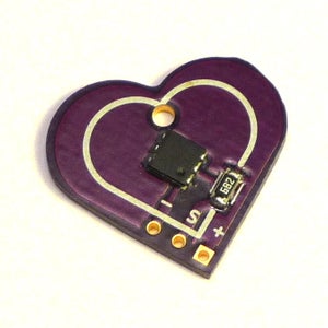

The PCB has three pads on the bottom, with the one in the middle marked "S", which we can assume means signal, and the ones on the edges marked "G", which by process of elimination we can assume are ground. Despite the chip having six legs, looking at the data sheet show that only two are used, one for ground and the other signal, or "IO".
The only real hitch for the Arduinoist is that the signal line requires a "strong" pull-up signal, which rules out using the internal ones. We need to wire something in the 4.7K - 8.2K ohm range. I'm using a 6.8K ohm resistor. See the diagram if you are unsure how pull-ups work. They basically ensure the signal line is at 5 volts unless a signal pulls it low.
On the PCB I designed, I decided to add the resistor to make it easy to interface to. All you need is a three pin male header. You can set the Arduino pins to be ground or supply by setting the pinmode to OUTPUT, and then setting them either HIGH (for source) or LOW (for ground).

On the PCB I designed, I created a heart silkscreen pattern for the front, and laid out a large gold pad on the back.
