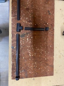

    Step 1: Mechanical Design

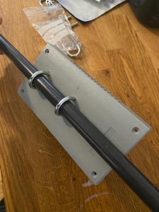

    My hobbies usually focus on electronics however a large part of this build was actually mechanical.

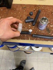

    The main structure of the metal detector is made from 20mm PVC pipe. It is important that the components of the metal detector are plastic so they do not create any inductive interference with the detector coils.

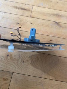

    The detector coils are held in place by being fixed to a laser cut piece of acrylic which forms the detector assembly. Underneath the main black coil holder plate is another clear acrylic plate held in place by nylon bolts which is there to protect the coils from being damaged.

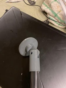

    The detector assembly is connected to the metal detector shaft via a clevis joint. It is important that all parts are plastic so the clevis joint was 3D printed from PLA and the connection between the two halves of the clevis joint was made using an M6x40 nylon bolt. The Clevis joint was designed using Fusion 360 then sliced with Cura and printed using an Ender 3 Pro. It is important to add the scaffolding supports when printing the Clevis joint as there are several hollow sections that need support during the print.

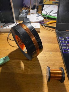

    Step 2: Sensor Coil Design

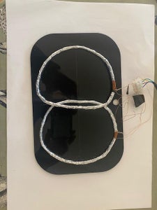

    This metal detector design uses a method called induction balance. When using the induction balance method two coils are used, the Transmit Coil (Tx) and the Receive Coil (Rx). Both coils are made up of 70 turns of 0.33mm diameter enamelled copper wire wound round a 150mm former. I utilised a ductape roll as the former.
    Transmitter coil - The control unit generates an alternating current which is sent to the Tx coil. A 555 Timer IC (Integrated Circuit) is utilised in this design to generate a square wave oscillation at a frequency between 400 Hz and 1000 Hz. Most induction balance metal detectors I have seen online do not have variable frequency so I integrated it into my design to see how it effects the performance.
    Receiver coil - This coil acts as an antenna to pick up and amplify frequencies coming from target objects in the ground. The Rx coil is connected to a second 555 Timer IC which is setup as a Schmidt Trigger via a general purpose Transistor. If even a small signal is passed up the Rx coil this gets amplified by the transistor, setting off the 555 IC Schmidt Trigger which then alerts the user via a buzzer and /or LED indicator.
    The current moving through the transmitter coil creates an electromagnetic field, the polarity of this magnetic field is perpendicular to the coil of wire. Each time the current changes direction, the polarity of the magnetic field changes. When the coils are held parallel to the ground the magnetic field is constantly pushing down into the ground and then pulling back out of it.
    The pairs of coils are set up to overlap twice so that the electromagnetic field from the Tx coil is completely nulled out on the Rx coil when they are in the perfect position. Any deviation on the in this balance causes a signal to be sent back up the Rx coil. This is because if the Tx coil passes over a metallic object a magnetic field is induced in it which the also gets passed to the Rx coil to the receiver part of the controller for further amplification.
    When winding the coils it is important to mark the wire at the start and end of the coil, the end wire on both coils is connected to ground. After finishing winding each coil I wound insulation tape round the whole coil. A second bare conductive wire is the soldered to the end wire and wrapped round the insulation tape round about 90% of the coil. Both coils are shielded by using self adhesive aluminium foil tape this foil makes contact with the bare wire wrapped around the coil (insulated by the insulation tape) which is then connected to ground when the coils are connected.

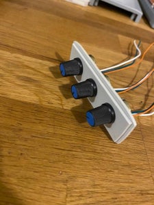

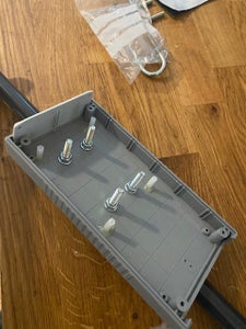

    The electronics was built using the schematic diagram above and soldering everything to a copper dot prototyping board (perf board).
