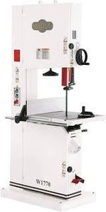

Tools Used:
  1. Metal cutting bandsaw
  2. Planer
  3. Circular saw
  4. Bandsaw
  5. MIG welder
  6. Welding magnets
  7. Grinder
  8. Handheld drill (Center drill + a couple drills in between that and 1/2", for making holes to bolt wood down.)
  9. Cutting oil

Step 5: Cut/Prepare Wood
Either use some purchased wood or some bum ass scrap wood to go on top. (These steps will be for non-purchased wood)
  1. Use a circular saw for a length of ~65.5"
  2. Split the planks on the band saw (or not if you have a not to thick piece, my plank started at 2 inches thick so anything around that thick is pushing the bench height a too high.)
  3. Plane planks ( I planed mine to 1 inch thick)
  4. Trim sides lengthwise on bandsaw. (I trimmed to have about 8.5")
