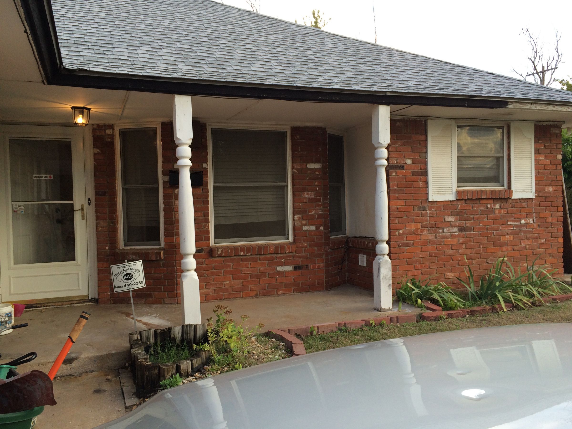

Okay... so initially I made this because my bedframe broke and was meant to be a temporary fun fix! However, in Oklahoma... we have been getting a lot of little annoying earthquakes....grrrr... not enough to crumble a house, but enough to make cracks in a wall, or in the concrete, or ones that disturb your sleep and startle you on a regular basis ie: (3's,4's,5's)!!!! Let me tell you how annoying that is........
This has been a total cure!!!!! Who knew?!!!!
Industrial.... but I am sleepin like a baby:)
