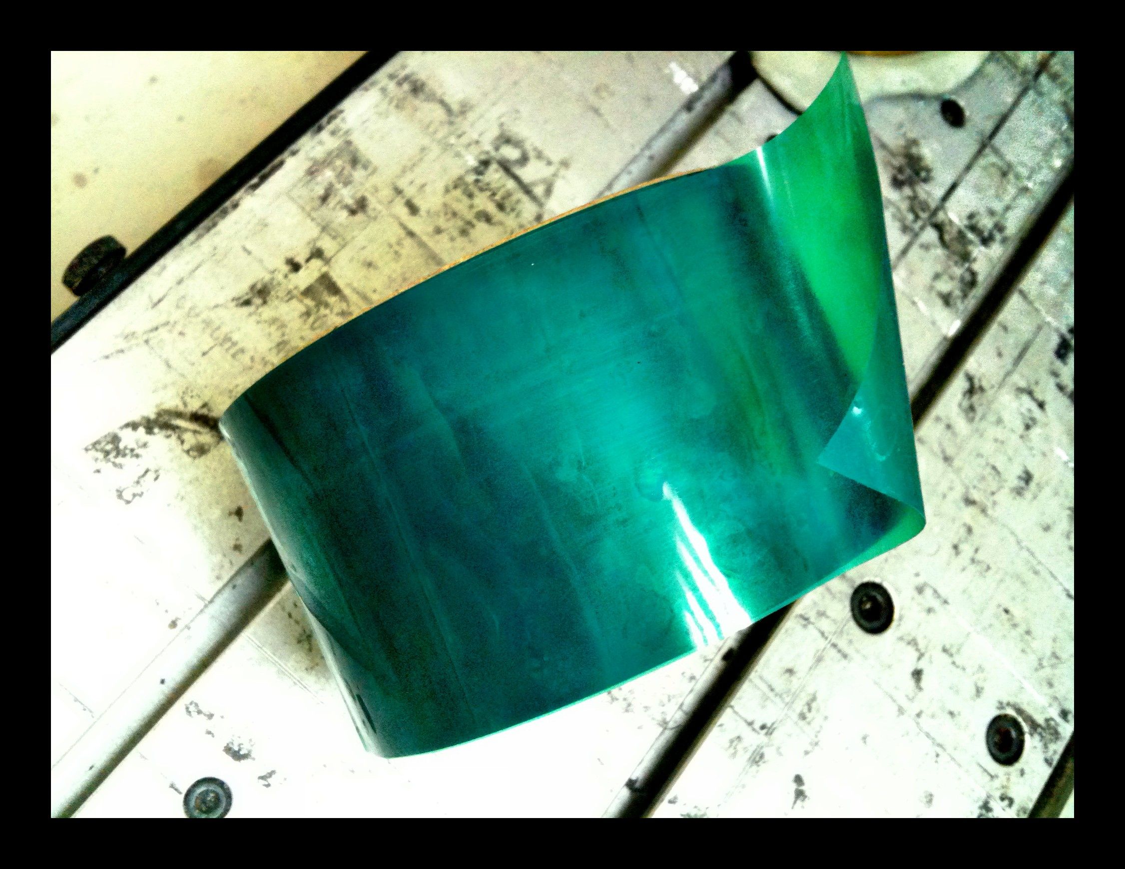

Take the panel into a well ventilated area, such as outdoors in the weather permits or a garage or spray booth.
Apply an even thin coat over the areas to be engraved. (making sure to not cause thick areas or under covered areas)
Let the panel dry. It should go from it's original light army green to a more pale version of it. A hair dryer or heat gun can
be used to speed up the process keeping the end of the gun at a reasonable distance from the material.

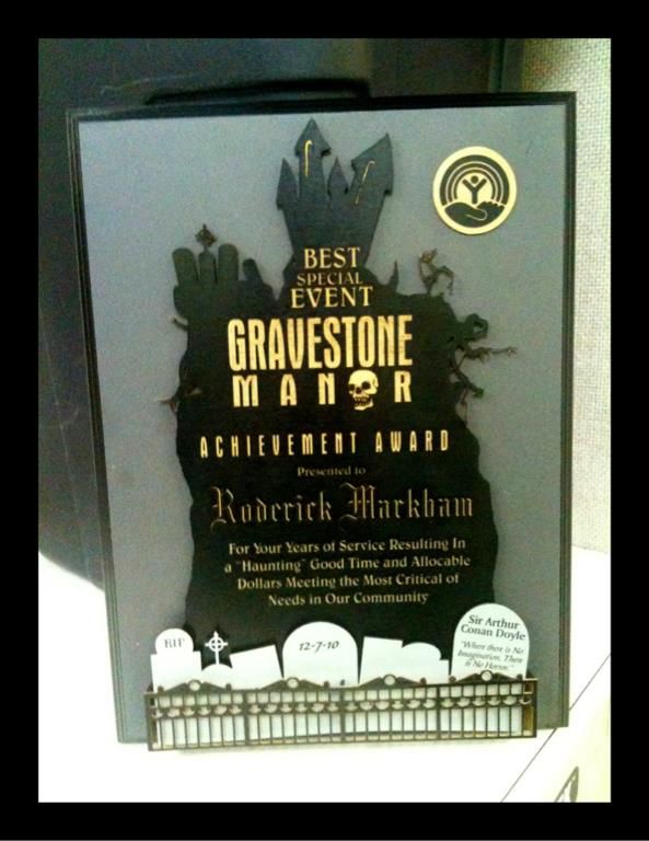

It is an amazing product with countless applications (this being one) such as
tool, electrical plates and ipod (metal back) marking, tile and glass (with Cermark for glass/tile) just to name a few.
