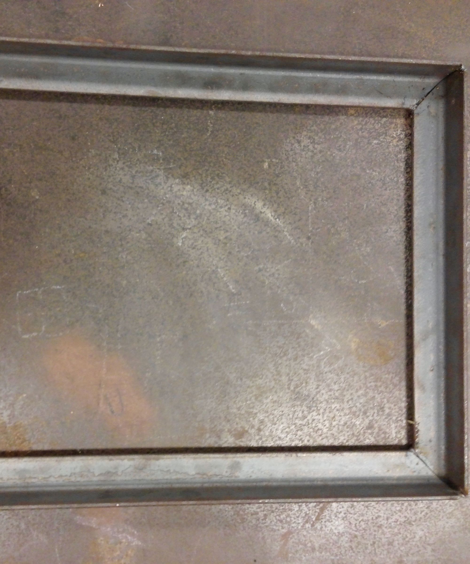

Step 6: Bending!
To start off, you want to mark where your base is with a ruler and metal chalk (the middle square). These lines are going to be where you grind.
Gently, making a straight line, use the Cordless Angle Grinder to grind on the line. Thus, making that area thinner and easier to manipulate. Now, bend the metal on the line till it is slanted. Do this to all sides of the fire pit. Once finished, they should all look even.
Step 7: Welding!
To start off you will need the Welding Magnet Arrow Holders to hold the sides of your project together well you weld. Locate four magnets inside of the firepit just to hold it well you put a simple dotted weld to hold the sides together well you do the real weld.
The magnets, if placed there for a long time well welding, will start to melt. That's why you dot weld by strategically placing 3-4 circular welds to hold the sides together like "glue" until you can put a whole bead down.
Once you have your dot welds done, you can take the magnets off (if done correctly the dots should hold the pieces together long enough.)
Now you can finish welding the rest of your projects!
