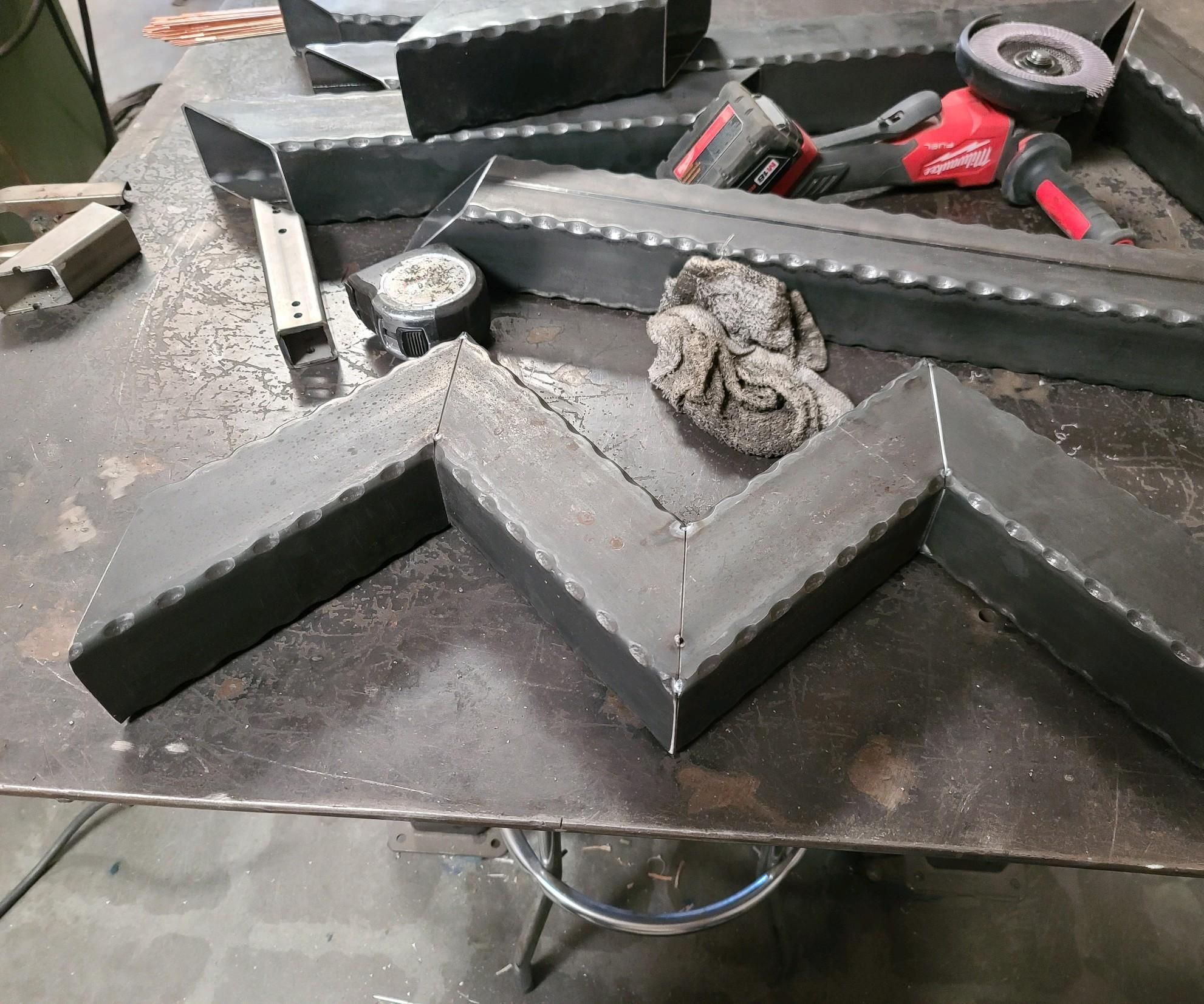

Cut 4 32in long pieces 45 degrees at each end. Then cut another 4 19.5in pieces 45 degrees at each end using a 14in cold saw.
Step 2: Clean Up Edges
Use the 4in an angle grinder to clean up the edges of the cuts. Make sure the edges are nice and smooth with no jagged edges or hanging metal. Do not grind down enough to change the shape of the edges.
Step 3: Tac and Weld the Material
Once you have found the shape that you would like your legs to be at. Use the TIG welder and tac your pieces into place make sure that your pieces of metal line up as nicely as they can with the smallest gaps possible. After Taced used the TIG welder to weld all of the seams shut. After the Metal has been welded together go over and make sure you did not forget any.
Step 4: Weld Tabs Onto the Legs
On two of the 32in long pieces TAc and weld the Tabs on both sides 4 inches away from the end. Each Leg should have 4 making in total on both legs.
