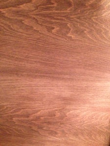

Step 10: Stain and Weather Coat Wood Desk Top
Sand down door with 220 fine grit sandpaper and wipe off all wood dust.
Using a wide, good quality brush lay down a coat of wood stain with the table top lying flat on the ground. Wait 5-15 minutes for penetration (longer will make it stain darker), then using a cloth wipe off excess stain.
Coat and wipe off stain application in direction of wood grain, using even strokes. When removing excess you can even out coloring by applying some pressure onto the wood.
Let dry for 4-6 hours and coat underside of table top.
A second coat can be applied for darker stain.
Wait a day then spray coat or brush with polyurethane sealant. This will prevent water damage if you spill on the table. 2-3 coats can be applied. I prefer matte finish for the wood.
