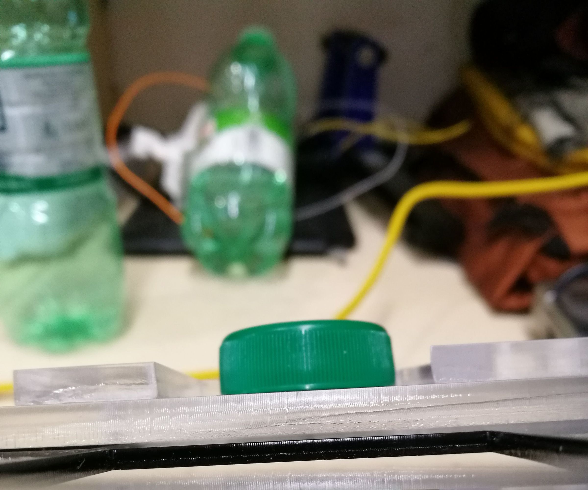

Given the wet environment the plant unit has to be build into a water proof cabinet allowing for wifi connection.
This cabinet is made of three chambers to keep the water flow separated from the control flow. The right chamber contains the controlling units. The middle chamber the power supply and the left chamber the valve and connections to the irrigation system.
The cabinet measures app. 115 X 70 X 40 mm.
In the picture are shown the pump, battery, relay, wifi board and sensor as they are placed in the cabinet.
