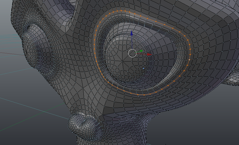

Step 5: Edge Loop
[Alt] + [Right Click] on an edge between two vertices. This will only work as well as your topology is.

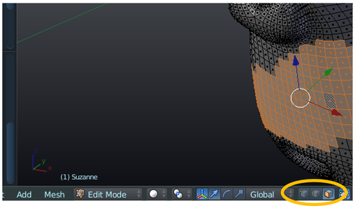

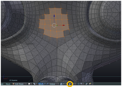

Step 6: Vertices, Edges, Faces
Usually you should select the vertices, but occassionally it is smart to select the faces or edges. This can be done by changing what you want to select as seen in the image below. This can also be done witht the hotkey [Ctrl]+[Tab].

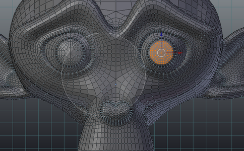

Step 8: Circle Selection
[C] This will allow you to color over your model and anything within the circle will be selected. You can adjust the circle size by scrolling. When finished with your selection push [Enter] to apply or [Esc] to exit.

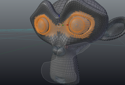

Step 9: Lasso Selection
[Ctrl] + [Right Click Drag] Draw the shape around what you want to select.

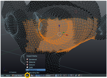

Step 11: Wireframe

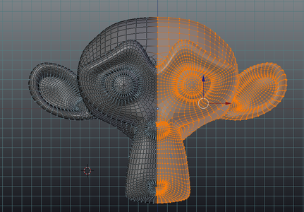

This is not a selection, it is view that will make selection easier. You can go into wireframe with [Z] or using the button seen below. Note that your selection will be both the front and back of your model now.

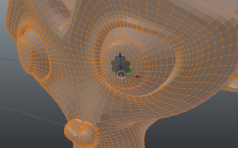

Step 12: See Through Selection
Another way to select everything in front and in back is to turn on the see through feature by pushing the button. Your model will go see through as seen below.

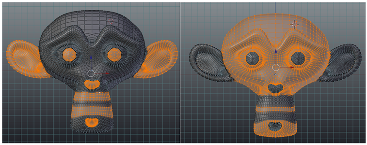

Step 13: Linked Selection
[L] This is extremely useful as it will guess selections for you. An example is when you want to split an object into two you can use this to select the object. You can also slowly adjust the selection with [Ctrl] + [+] or [-] to grow or shrink it as seen below.
Step 14: Invert Selection
[Ctrl]+[I] will make what you have selected and deselect that and make everything else selected.

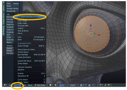

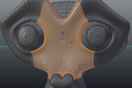

Step 16: Inner Loop Selection
First select an edge loop, as mentioned earlier, then go into the select menu and choose "select loop inner-region" as seen in the image below.
