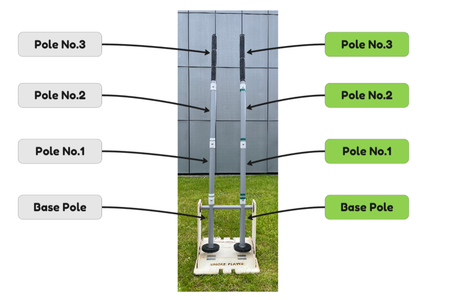

Step 4: Assembling the Poles

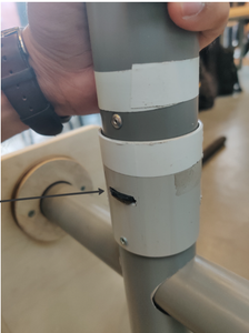

We will first start by assembling the poles together.
Step 5: Poles Assembly
For ease of understanding we have color coded the pole on the left as white and the pole on the right as green. Each pole is divided into four parts, Base pole, Pole 1, Pole 2 and Pole 3.
Step 6:

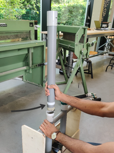

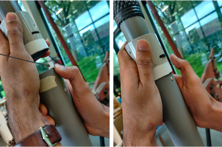

Grab Pole No.1 of the same color as the base pole color
Make sure the side with the color strip is facing down.
  • Press the Locking tab inward with your thumb and press the pole inside the base pole.
  • Twist the pipe from left and right until the plastic locking tab pops out of the hole.
Then grab Pole No.2 and repeate the steps.
Then grab Pole No.3 and repeate the steps.

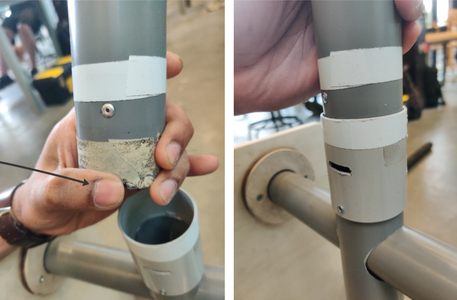

Step 7:
Step 8:
Twist the pipe from left and right until the Locking tab pops out of the hole.
Step 9:

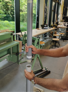

Grab Pole No.2 of the same color. Make sure the side with the color strip is facing down.
Step 10:
  • Press the Locking tab inward with your thumb and press the pole inside pole No.1.
  • Twist the pipe from left and right until the Locking tab pops out of the hole.
Step 11:
Grab Pole No.3 of the same color.
Step 12:
  • Press the Locking tab inward with your thumb and press the pole inside pole No.2.

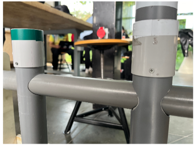

Step 13:
Repeat the steps for the other color pole on the right side.

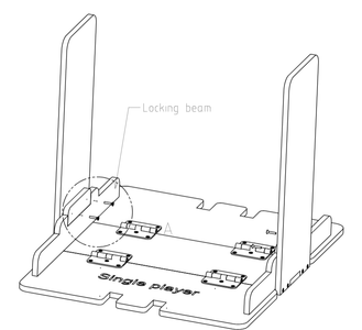

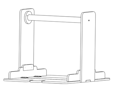

Step 14: Box Assembly
After the poles are assembled we move on to the assembly of the Box.
Step 15:
Unhook both Carabiners andSide panels folds open
Step 16:
Press in both locking beams on each side panels. Make sure they're fully slid in.

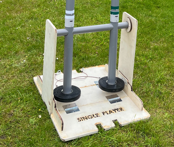

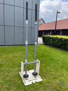

Step 17: Fully Assembled
The entire assembly should be fully assembled for two players.

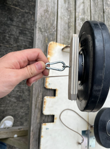

Step 18: Single Player
For Single Player, tilt the pole to expose the hook in the bottom .
Lock in the carabiners in the eye of the hook screws under the poles.
The Player should stand on the side where the letters "Single Player" is etched to start playing.

Now we focus on manufacturing the entire thing. We will start by manufacturing one of the poles
Step 20:
We have color coded the poles and divided each side it into four parts each. Base pole, Pole 1, Pole 2 and Pole 3. We will start by making the Base pole first.

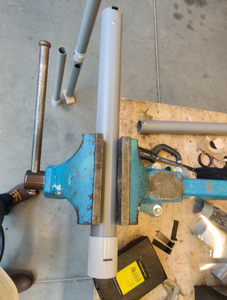

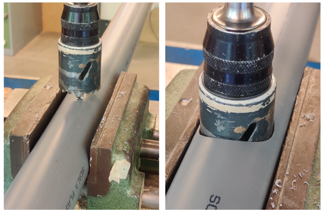

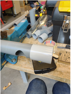

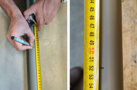

Step 21: Base Pole

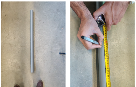

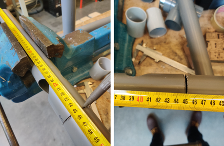

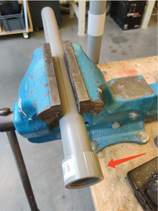

Take the standard 50mm 100 cm long PVC pipe and mark a spot at 38.5 cm from one end
Step 22: Base Pole
Drill a Hole of 41cm diameter all the way through using the center as the marked spot in the previous step.(don't forget to sand the edges of a smoother movement).
Step 23:
Measure a length of 45cm from the same end you measured the length for the hole and cut it at that spot.
Step 24:

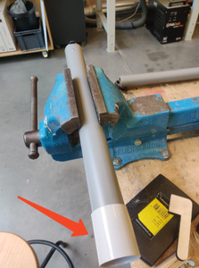

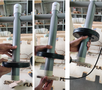

Place a Standard 50mm to 50mm connector on the side towards the hole and secure it by screwing two screws on the sides.
Step 25:

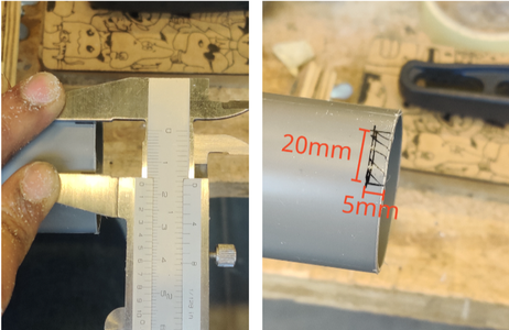

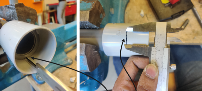

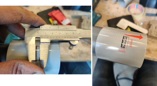

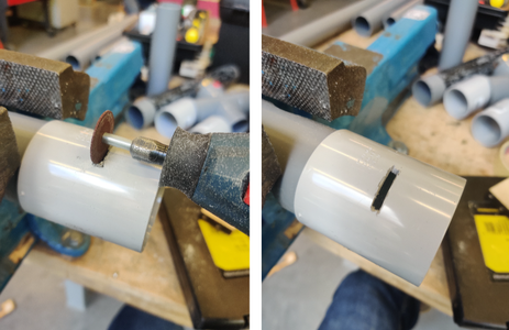

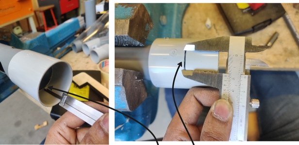

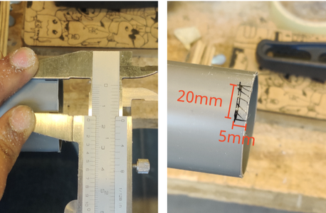

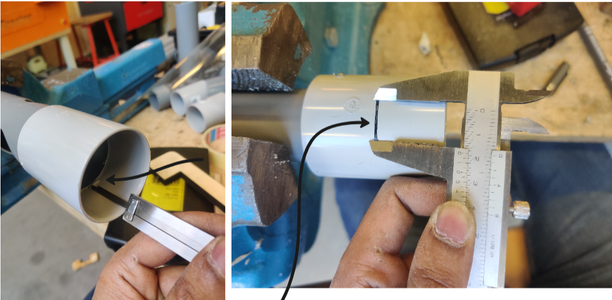

Measure the distance inside from the open end of the connector to the small plastic extrusion that stops the pipes. Mark a 20mm line at the same distance on the outside (make sure it's in between the holes going through the pole).
Step 26:
Make another line at a distance of 5mm (Make sure the new line is towards the open end and not towards the pole side)

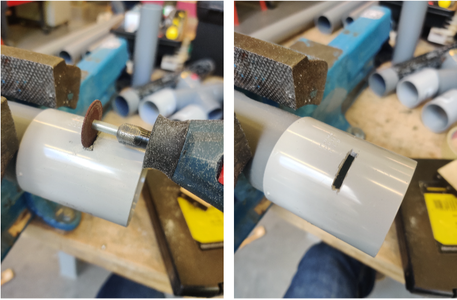

Step 27:
Using a Dremel Cut out the rectangle you just made.
Step 28:
Put the 2KG weight through the bottom end of the pole and lock the weight by putting the weight locking assembly inside the open end and securing it using 4 screws. The weight locking structure is made screwing a 47mm circle to a square piece using two screws. A small screwable ring is added in the bottom on the other side on the center.(All Parts are included in the Part files)

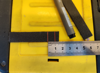

Step 29: Plastic Strip

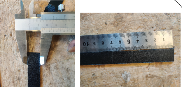

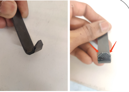

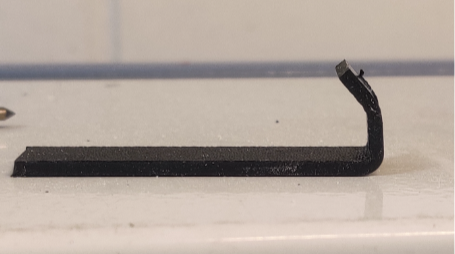

Before we start making the rest of the pole we have to make six plastic clips that go into both the poles (3 in each).

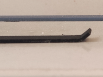

Step 30:

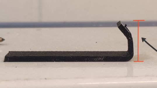

Take a 3mm thick plastic sheet and cut it into strips that are 15mm wide and 70mm long.
Make two markings at 5mm and at 15mm

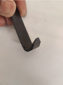

Step 31:
Make the first bend of 40 degrees at the 5mm marks
Make the second bend of 90 degrees at the distance of 15mm.
Step 32:
Snip off the edges of the bent portion.
Step 33:
Repeat the steps until you have 6 clips. We can trim the length of the portion that pops out later in assembly for perfect fit

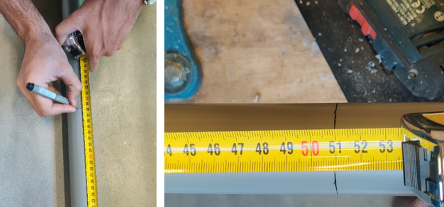

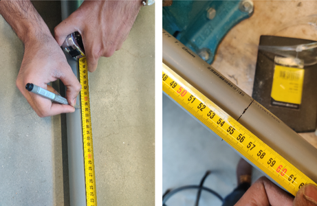

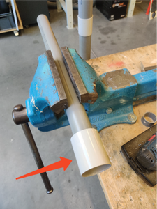

Take the standard 50mm diameter PVC pipe and mark and cut it at 52cm distance

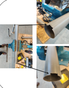

Step 36:

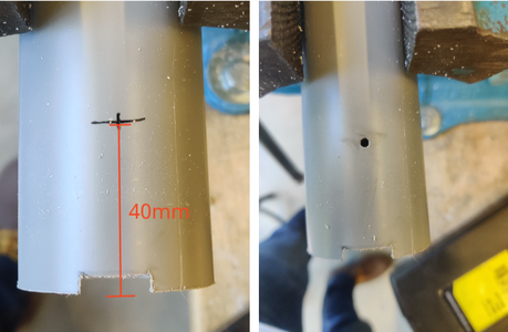

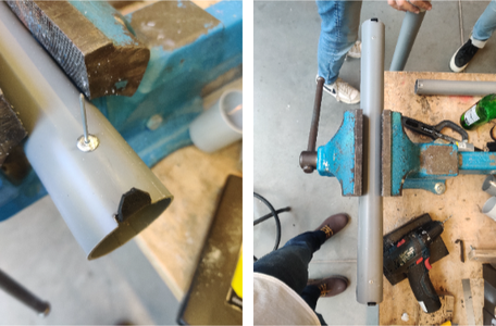

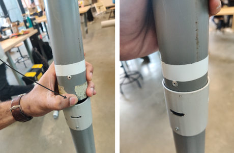

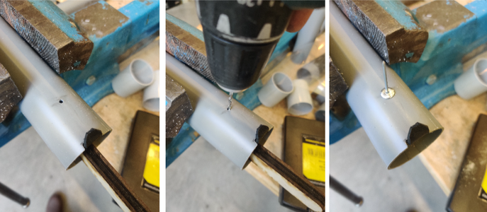

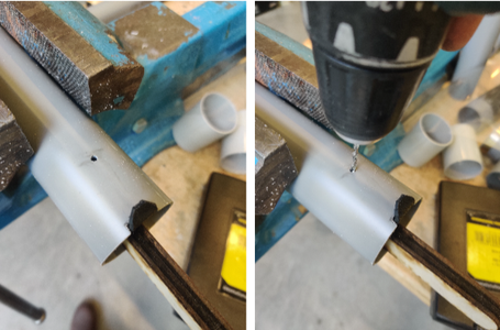

On one end mark two lines at 20mm and one line 5mm from the edge. cut out the rectangle using a Dremel.
Step 37:
Mark a spot 40mm from the edge and make sure it's in center of the notch we made in the previous step. Now drill a hole of 3mm in that spot.
Step 38:
Place one of the plastic tabs inside the pipe such that the portion that is bent is popping out of the notch in the pipe (make sure the plastic tab doesn't extrude beyond the edge of the pipe and is flush with the end).
Holding the plastic tab in place drill through the tab using the same hole you drilled earlier. Finally put a rivet through the hole and rivet the plastic tab with the pipe.

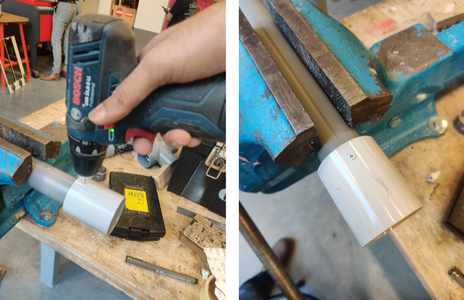

Place a Standard 50mm to 50mm connector on the other side and secure it by screwing two screws on the sides.
Step 40:
Measure the distance from the open end of the connector to the small plastic extrusion that stops the pipes. Mark a 20mm line at the same distance on the outside (make sure it's in between the holes going through the pole).
Step 41:
Step 42:

Take the standard 50mm inside diameter PVC pipe and mark and cut it at 55cm distance
Step 45:

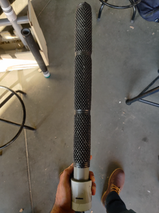

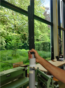

Wrap the exposed PVC pipe side with a soft material for improved safety.

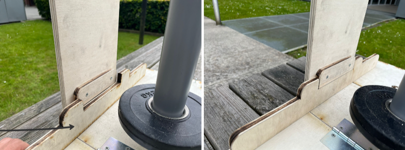

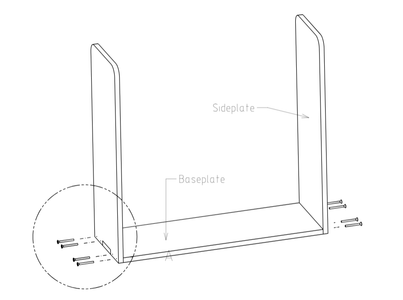

Step 1
  • Put the side plates against the baseplate as picutureabove.
  • Pre- drill the marks on the sideplate and extend the drilled hole to the baseplate.
  • Attach the sideplates to the baseplate using the pre- drilled holes with 4 screws per side.

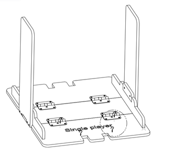

Step 60:

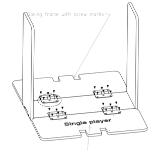

Step 2
  • Put the normal closing frame and the single player closing frame against the baseplate as pictured below
  • Lay four hinges centered in between the baseplate and the closing frames, 9cm away from the edge of the closing frame
  • Pre- drill screw holes for the hinge and put all the screws at the wright locations.

Step 3
  • Put the sideplates against the baseplate as picuted below.

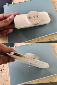

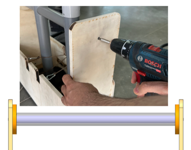

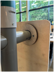

Step 63: Central Axles
Now we will make the central axles on which the poles rotates.

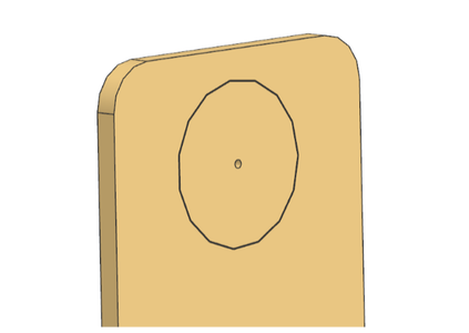

Step 64:
Predrill (2mm) hole through the guide points on Side panel

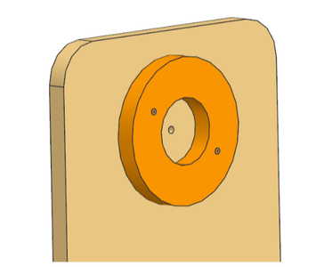

Step 65:
Screw in Mounting Disc on the side panels using two (m4 x 20) screws.

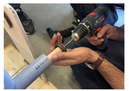

Step 66:

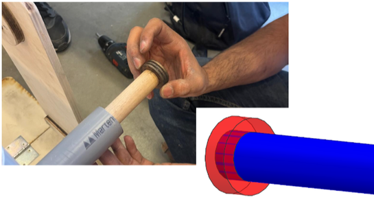

Drill 2mm guiding hole in both end of the wooden pole
Step 67:
Press fit wooden spacers on each end of the wooden pole
Step 68:

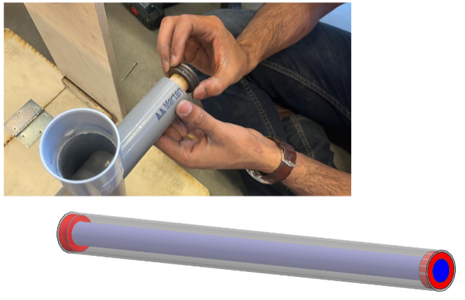

slide in the wooden pole, with the spacers, inside the PVC base pole
Step 69:
Slide in both PVC base poles on the PVC pipe Axle
Step 70:
Lock in the PVC pipe in between the two Mounting Discs
Step 71:
Screw in two (m4x 80) screws on each side of the side panels through the guiding holes.
Make sure to screw them on both sides at the same time in order to prevent the wooden pole to rotate inside the PVC pipe axle

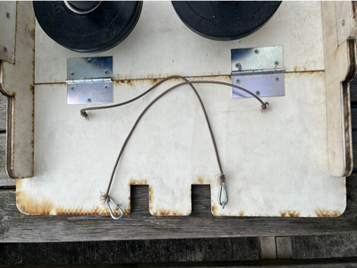

Step 72: Elastics
Tie an elastic to the eyes of the hooks attached to the doors and the attach a Carbiener on the other end.
Step 73: Finished
