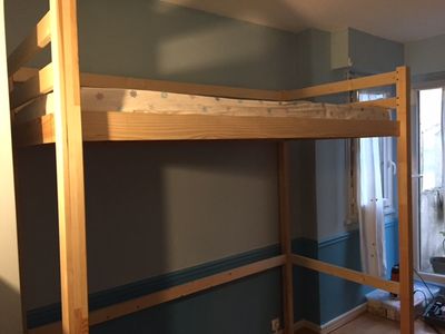

As a present for her 6th birthday, my younger daughter wanted a mezzanine bed like her older sister. After my first woodworking project, an outdoor table that you can check here, I decided to build this mezzanine bed myself.
I studied how my other daughter's mezzanine bed was made and how others I found on the Internet were made. The most common way to assemble the sides of the bed frame to the posts is using long metal screws, which means drilling deep holes as straight as possible. If you don't have a drill press, this is not easy. There are drilling jigs available, but for such deep holes, they're not perfect and can get you a few millimetres off.
I decided to look for alternatives and I wondered whether I could instead assemble the bed frame first and then insert it into blind dados I would cut into the posts. My main concern was whether this would be strong enough. After several people on woodworking forums told me it would be strong enough I decided to start this project.
It took me 4 days to complete this mezzanine bed and for the assembly of the bed frame with the posts, I asked somebody to help me hold the wood pieces, as it can be quite heavy.
DISCLAIMER: This bed is pretty strong for my needs. My daughter has been sleeping in it for over a month. I have climbed in it with her and it's not moving at all. However, I'm not an expert in mezzanine bed safety and I know that the safety rules for this kind of bed are different across countries. Please follow this instructable at your own risk!

Step 11: Sand, Varnish and Secure to the Wall
Do several passes of sanding starting with coarse grain and then using finer grain at each step, until smooth enough for you.
Apply varnish all over the bed, 3 times, sanding with super fine grain between each coat.
When this is done, you can secure the back legs to a wall using a metal bracket (picture 3).
