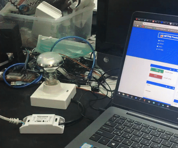

I read this article form 陳亮 (moononournation github) about how to use esp32 ble for scan the device so i had to try this code on github Arduino_BLE_Scanner. now i want to use my Mi Band 3 to unlock the door when i come to my office, Let's see how it's work !!!

Step 5: Look at the LED on Board When You Come Close the Device
- When ESP32 detect your Mi Band the LED onboard will turn ON
- When ESP32 can not detect your Mi Band the LED onboard will turn OFF
