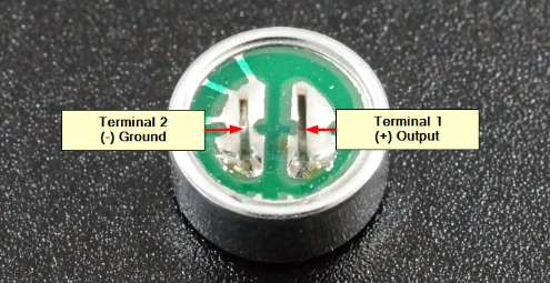

Step 3: Theory (Input Taken From Mic)
The mic is connected in series with the power source. It can generate a voltage on the output with sound. The voltage produced by the microphone is very low so it requires an amplifier circuit to amplify its level. A pull-up resistor in the range of kilo-ohm is used to supply power to the built-in FET impedance converter.

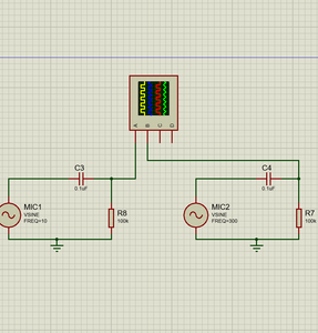

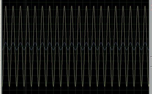

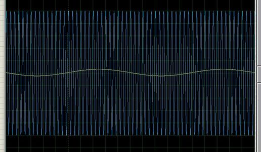

Step 4: Theory (High Pass Filter to Block Noise)
A high pass filter allows a high-frequency signal to pass but blocks a low-frequency signal. It is done by adding a resistor and capacitor. The cut of frequency can be calculated using the following formula: F = 1/ (2πRC). This means in our circuit the cut-off frequency is around 16Hz. So any signal at 16Hz or below will not pass. As you can see from the diagram, the higher frequency can easily pass but the lower frequency is highly attenuated.
This is necessary to remove the background noise. Since our audible range of humans is 20-20000Hz, this filter makes the circuit more accurate.
I have added the simulation file Here

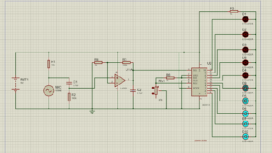

Step 7: Schematic
I have used proteus to complete the simulation, I have replaced the mic with an AC voltage source since the software would shut down each time I try to run the simulation. This mic can receive a signal from your laptop/PC mic and show the output. So, if your computer can handle the load you can change it to a mic and run the simulation.
I have added the final simulation file Here
