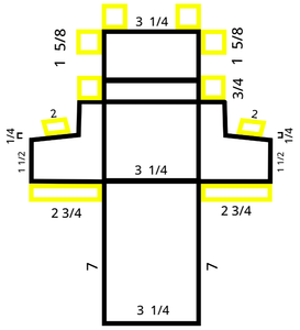

Step 1: Measuring the Box
First let's get some cardboard,
This arcade machine should be made out of light cardboard, slightly thicker then a cereal box, but not corrugated. The end result should be about the width and length of your micro-bit extension board.
For this project I will be using the measurements for this extension board (in the kit). Most extension boards that are smaller then 3.25 inches should work though.
Now you can use the pictures as a guide to measure your box, clicking them enlarges the pictures.
Step 2: Cutting and Adding to the Box
Now that we have box measured, it is time to cut it. Simply cut it out along the edge of the boarder,
Also looking at the pictures for text boxes.
Let us begin to measure holes to put things in.
1. Starting with the hole for the Micro-Bit, outline the uppermost part of the box upside down with your Micro-Bit, as in the pictures.
2. Now use a hole puncher to make a hole right were the battery pack is going to go through.
3. Finally, make a hole on the end of the box just big enough to fit your joystick.
