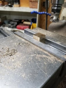

Step 1: Make or Obtain Brass Cube
Since we’ll be dividing the cube into a grid of 7x7x7, I started by choosing a final cube size that was easy to divide into 7 parts. I stated with 3/4" square bar which I then trimmed to 0.7". Each unit is therefore 0.1” (though I used a 3/32” end mill, so the final product is slightly imperfectly sized). It would be slightly easier to start with 1" square stock, trim to 7/8", then use a 1/8" end mill.
I used This Old Tony’s method (https://youtu.be/tW8HNAlUXxU) for making square stock; if you don’t want to watch the video I will summarise it briefly. Begin by facing off one side, taking off only enough to remove the factory surface. Deburr the edges and rotate that side so that it is against the fixed jaw of your vise. Face off the other two sides, deburring before replacing the stock in the vise. Then, cut the final 3 faces to size, taking passes and measuring frequently until the cube is the correct size.
Do note that the edges of the cube will be quite sharp before deburring. Handle with care.

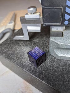

Step 3: Pattern Layout
Brass is soft and marks easily, but I still used marking compound (Dykem) for visibility. Using the height gauge and granite block, scribe out the grid in 0.1” increments on all 6 faces. If you don’t have a height gauge and granite block, you can use calipers, but be aware that the result won’t be as accurate. Once you’ve marked out the grid, transfer the pattern to at least three faces (I used the height gauge to mark out the center of the appropriate squares, but you can always scratch it out with a scribe if you prefer – these markings are purely for reference).
You can also transfer the pattern to the faces using a toner-transfer or other marking method. Having even a very rough and imperfect pattern is better than having no pattern at all - as the cube will constantly be rotated during milling, it's easy to lose track and make incorrect cuts.

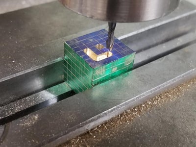

Step 4: Rough Milling
Note: the photo shown was from an earlier iteration, which is why it has holes in it. I later abandoned the idea of pre-drilling, so feel free to ignore them. I explain more about earlier versions in the last step.
This step is incredibly repetitive when done on a manual milling machine, and it’s easy to get confused. The general idea is to locate the edge of the part, locate the top of the part, identify the coordinates of the desired end of the cut, then turn the hand wheels until the tool is where you want it to be. I will go through the process for one set of cuts, and the rest are all the same.
The first set of cuts are 2 unit x 2 unit through cuts. Each side gets three such cuts: I see them as the “ears” and “hair” in the smiling face analogy. I kept my depth of cut to 1x the tool diameter and my stepover around 1/2x the tool diameter. Although accuracy is not super critical with a decorative project, I still measured the dimensions frequently as I approached the target size.
To start with, I chose the front-top-right corner as my zero point. Set the RPM to low (<1kRPM), load the edge finder, turn on the spindle, and locate the edge. Then, offset the tool by 1/2x the diameter of the edge finder (in my case, the edge finder is 0.2" diameter, so I offset by 0.1"). Zero the appropriate axis and repeat. Note that by doing so, you are locating the centerline of the spindle relative to the part.
Then, load the tool. There are a number of ways to locate the Z zero (feelers, paper, dial presetter, etc) but I just very slowly lowered the tool and moved it back and forth over the corner until the cut began. I then backed the tool off 0.001" and set the Z zero.
In the attached diagram, you will see that I have included the actual location of the edge as the primary dimension, and the location of the centerline of the tool in brackets. If I move the centerline of the tool to the location in brackets, the edge of the tool will be at the desired location. To come up with these values, I either added or subtracted the radius of the tool from the target location.
Begin taking the first cut. Since the tool is small, I took a series of passes from front to back, keeping the X axis constant and raising the Z axis after each pass. Then, I moved the X axis over and repeated. If you prefer, you can always use a larger end mill for this step, which would result in fewer passes.
In each orientation, you can do three cuts: two cuts from the front, and one cut from the side. After that you will need to remove the part from the vise and rotate it.
