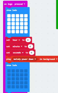

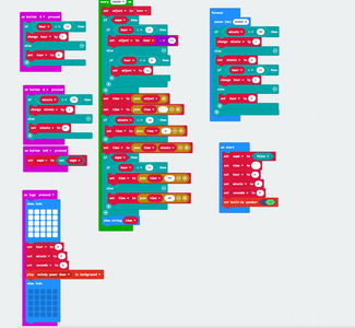

This photo right here is the code, which can be found on the Micro-Bit website. I then added the code in the second photo which when the logo of the microbit is pressed, the clock will reset to 00:00. Pressing 'A' will add a hour to the clock and pressing 'B' will add a minute to the clock. Pressing 'A+B' will trigger the change in AM and PM. The 5th picture limits the number shown to the amount of minutes in a hour and amount of hours in a day.

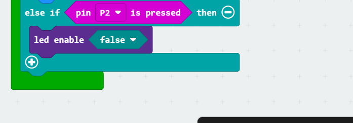

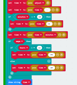

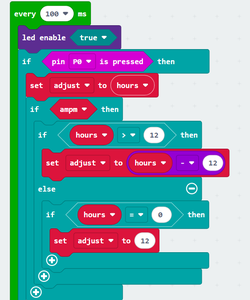

Finally the 6th picture shows how the clock counts and displays the time on the microbit light screen, and when pin 0 is pressed it turns on and when pin 2 is pressed then it turns off.
