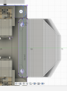

I designed this robot in Fusion360 First, the idea here was to make a base that will be used to screw motor mounts from the bottom side of the Base, and with 3 pillars, a PCB can be mounted on it. In between the PCB and Base, a Li-ion battery is placed. So this was the plan.

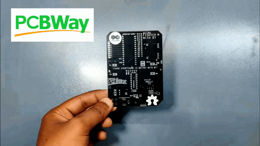

Step 2: PCB Design
The first step for making a PCB Project is to make a schematic that will have all the components that we need to run our project.
I Prepared a simple setup that consists of an Arduino Nano connected with the L293D Motor driver IC in its proper configuration, HC01 is also connected with the Arduino Nano.
I've used a 12V 2.6A Battery in this setup, It's not recommended to add 12V directly with Arduino's VIN port so I added AMS1117 to step down this 12V into 3.3V for Arduino and HC01 to run without any issue.
After finalizing this Schematic, I then Imported its netlist and converted this into a PCB Design.
As for the PCB Outline, I used the reference dimensions from the fusion360 Model and then made the PCB based on it. I exported the Gerber data and then send it to PCBWay for samples.

Step 3: PCBWAY Review
After sending the PCBs for manufacturing, it only took 7 days to get delivered.
The PCBs that I had received were nice as expected!
PCBWay you guys rock! Check out PCBWay for getting great PCB service at less cost!

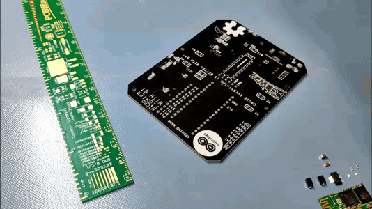

Step 5: PCB Assembly
After Receiving the PCB, all that was left to do was to apply solder paste to each component pad.
Step 6: 1. Solder Paste Dispencing
I used a normal Sn-Pb solder paste which has a melting temp from 140 to 270 °C
The solder paste Dispencing method is relatively easy, we apply a little amount of solder paste to each components pad one by one which will take time. After Adding solder paste, we need to do the "PICK and place Process"
Step 7: 2. PICK and Place Process
I then used an ESD Tweezer to carefully pick and place each component on their assigned place one by one which took like 3 mins top but end result was a perfect PCB with all the components place in their place in the right orientation.

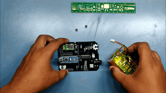

Step 9: 4. THT Components

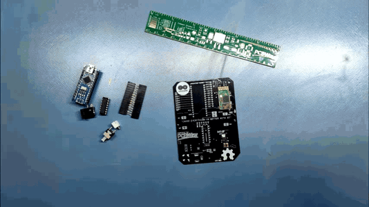

Now we have to add THT Components which are Header pins, DC Jack, L293D IC, and Battery JST Connector.
I just use a regular solder iron for this Job. at last, we put the Arduino Nano on the header pin.
I have added jumper pins on the PCB, these are connected in series with TX and RX.
You see, if we add RX and TX of Arduino with HC01 on the PCB directly without any Breakout point, we will not able to program the Arduino nano because of the UART Error.
I've added two header pins on PCB so I can short them and by this HC01 will communicate with the Arduino Nano, when we have to program the Arduino Nano, we only have to remove two jumpers from these header pins.
You could also remove the Arduino Nano and program it with the sketch and then put it back on the PCB, this method will work but it's too much work for me so I prefer to use header pins instead. Anyways, after doing this our PCB is finally ready. But we still have to check if the Circuit is working or not.

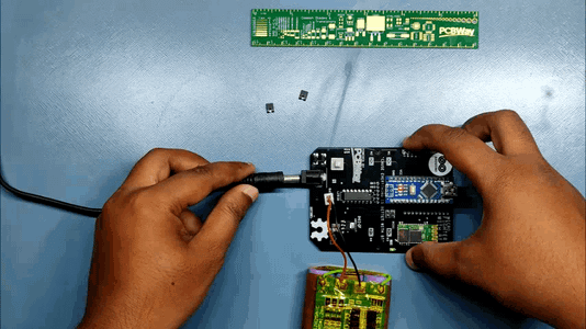

For Testing this board, I will use two things basically, first, I will use this battery which is a Li-ion battery pack 12V, I have a BMS on it so we don't have to worry about it many things related to its battery protection.
  • we first add the battery onto our PCB with the JST connect in the right polarity.
  • then we turn on the switch and our Arduino nano along with HC01 are working.HC05 LED is blinking and LED is Glowing in Arduino nano, this means that both of these modules are working without any problem.
  • Next, I added a 12V 5A SMPS on the DC Barrel jack, this is for charging the onboard battery pack. LED on the DC Jack side is glowing which means everything is nice and dandy.
  • now, at last, I took out my phone and paired it with the HC01 Module.
  • then I opened a Bluetooth terminal app in my phone and connected the HC01 with it. as soon as it gets connected, The LED Stopped its frequent blinking sequence which is a sign that the module is now connected with the device.
So our PCB has now qualified its testing process and now we will prepare the 3D Printed Base Body which will hold the PCB and other stuff.

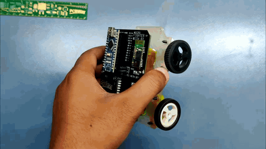

Step 11: 3D Printed Parts and Body Assembly
here's this lower base that is holding four DC motors with a motor mounting bracket from the bottom side.
Then three pillars are on the opposite side, these pillars will be used to mount PCB and Base together. In between PCB and Base, a Li-ion battery is placed so it is all a compact setup that holds everything together nicely.
As for the material for these 3D Printed Parts, I'm going with the transparent PLA and Transparent yellow PLA which kinda look like the golden color but it's not.
After adding everything together, I then added the battery in the middle part and connected its terminal with the JST connector.
then I added wires to the motor and PCB in the given order

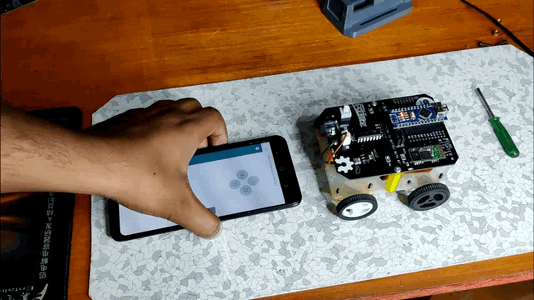

Step 13: APP

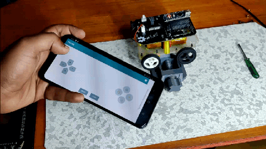

Now, the previous version was controller by a blynk app but I'm not using ESP32 or ESP8266 in this project. We required a Bluetooth terminal app here.
I'm using this Bluetooth controller app that you can download from the google play store.
https://play.google.com/store/apps/details?id=com....
Open this app and pair your HC01 with it, after that open its controller mode and assign the Buttons their value which is in our case these.
  • TL for Turn Left
  • TR for Turn right
  • F for Forward
  • R for Reverse
  • S for Stop
Now we just press any button to control this robot!

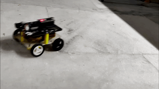

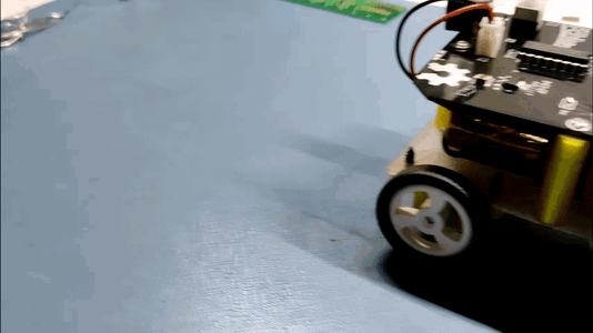

As you can see, our robot is working! and it's pretty fast which was my goal, to make it as fast and sturdy as possible.
Now, this setup works like a development platform, a micro fighter platform.
the idea here is to make multiple of these robots and let them do fighting and stuff.
