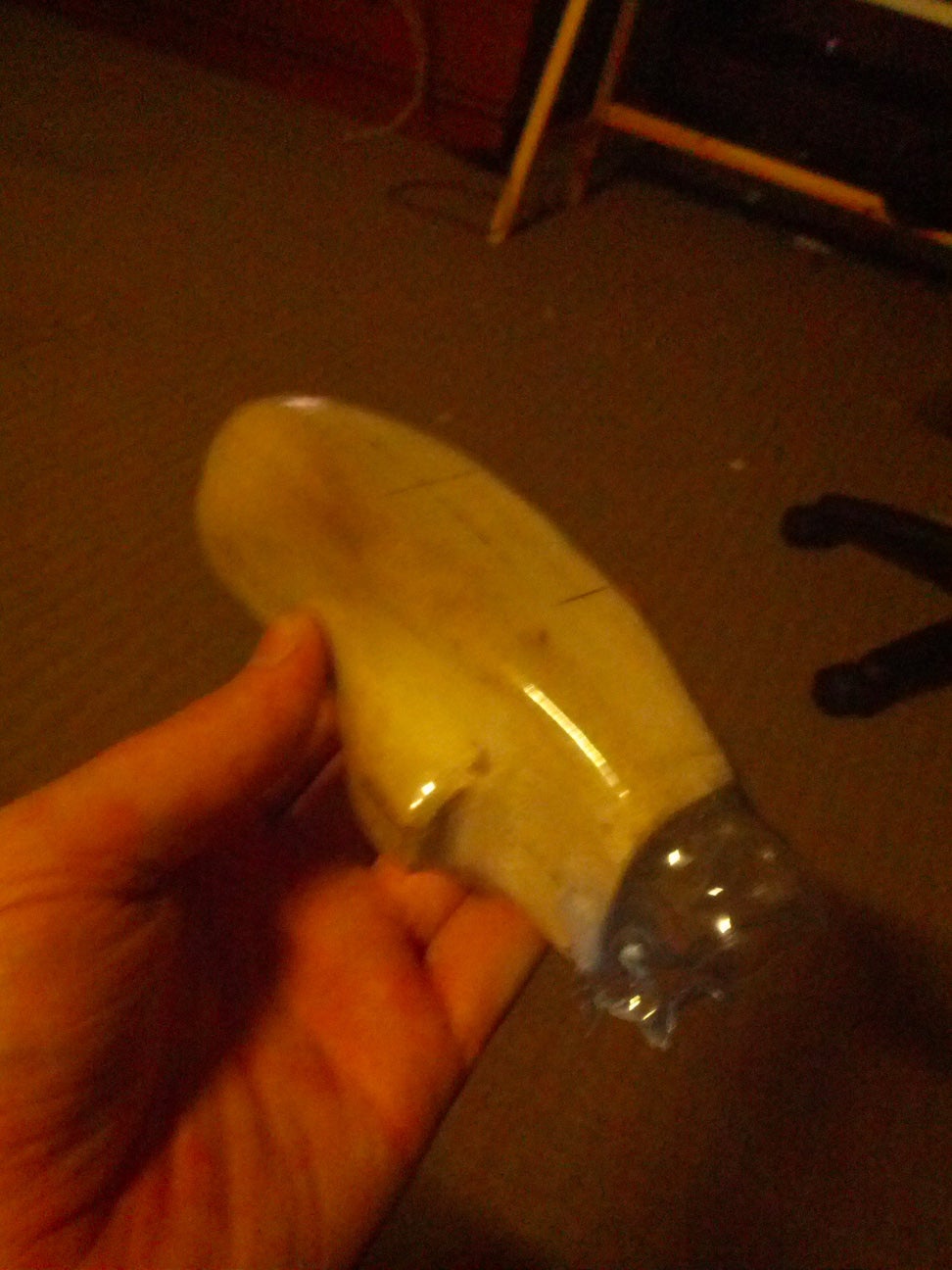

Step 12: Making the Canopy
The canopy really adds the Wow factor to this build. On a practical front, it also adds considerable protection to the FC and other electronics. And, in cases where you could encounter some moisture/rain, it protects the sensitive electronics from water-related shorts.
By far the hardest part of this step is making the mold! I carved mine from a block of balsa wood. Again, refer to the plans for the required dimensions.
Once you have carved/sanded the mold, it's simply a matter of putting the mold inside a PET plastic bottle (I used a small spring water bottle) and using a heat gun to shrink it around the mold.
Use a hobby knife and cut a line down the center of the canopy, on the underside (in a Y-shape). You should then be able to remove the mold relatively unharmed.
Then you need to trim the plastic canopy to fit. This will take a number of attempts where you make small cuts, to leave room for the arms, etc, with repeated test-fits. See 3rd pic for reference of the desired final result.
