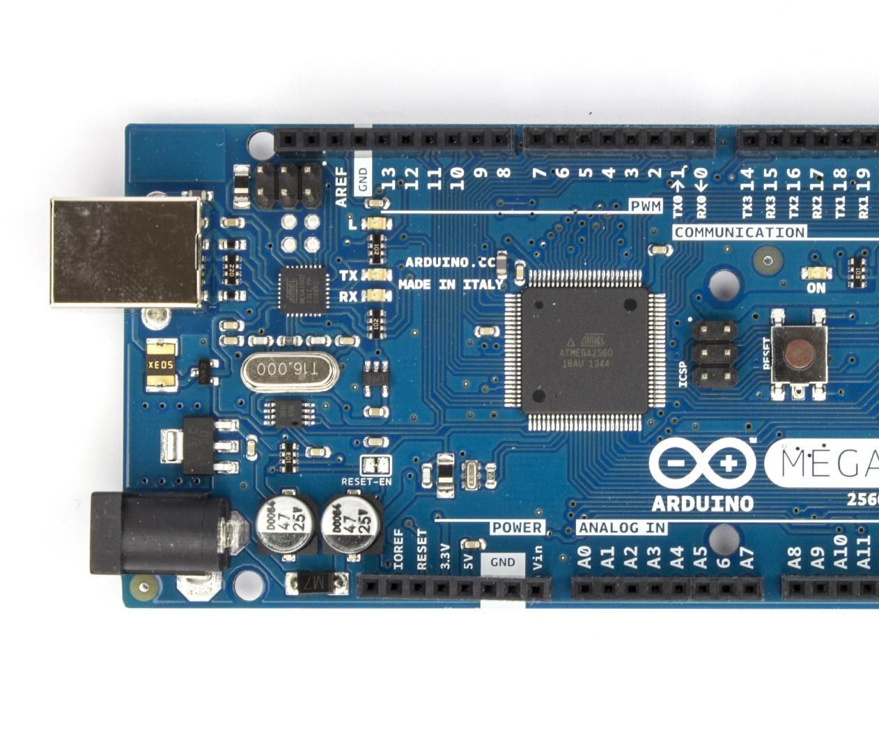

The video gives a first impression how it works on a UNO. On a standard MEGA it's about 50% slower, because the Mega code splits the used pins over multiple IO ports, requiring more software interaction to write a single pixel to the display. This GUI is in no way compare-able to most (semi-) commercial solutions like LvGL or TouchGFX on STM32. The main purpose is to foresee a basic easy-to-configure GUI that has minimal requirements and uses low power. In the example it even runs in your loop function, so you have to make sure it's run frequently enough to still react reasonable to user actions.
Required:
  1. Arduino UNO or Mega. This source code targets AVR processors.
  2. Preferably a Parallel (8bit) connected display that has positive coordinates (X, Y = 0, 0 on one edge and ex. 479, 319 at the other edge).
  3. On the UNO a parallel display severely brings down remaining I/Opins for your application. Using SPI or I2C reduces the Display IO pin requirements but will noticeably slow down the user experience. However, on the UNO you only have a few IO pins left when connecting the display on a parallel bus (ex. D0 and D1 are required for Serial functions / not used by the display hardware).
  4. Arduino IDE functional on your computer.
  5. The display dependencies (Adafruit GFX, MCUFriend stuff etc).
