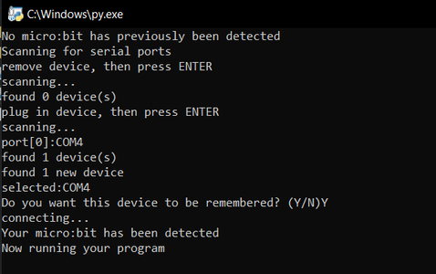

1. Open the joystick.py code from [downloaded code](https://github.com/aniketdhole07/Micro-Joystick)
2. Run the code
3. The output of code will ask to Reinsert the Microbit, so it can detect the Port.
4. It will start printing the Serial Data of Accelerator,in x y and z axis.
5. Run any game and Press the A button on Microbit to Start Playing.

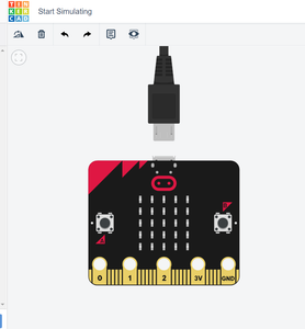

Step 5: TinkerCad Simulation
TinkerCad is a great platform to simulate electronics.
I tried simulating the micro:bit board here before buying to check for the sensor data.
