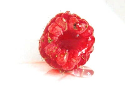

Step 8: Now That You Have the Image....
Post Work done in gimp, pretty much the same in Photoshop:
Went to Colors>levels in Gimp
Went to select white point (little eye dropper on bottom)
Picked a gray area in the image.
Pressed ok.
Went to Color>Color balance
Brought red and green a little bit over.
pressed ok.
Select the reflection using magnetic laso.
bring red over all the way, and pink over halfway in color balance.
This brought the dingy, grey white picture you saw in step 6, to this polished mouth watering raspberry.
Adjust the editing for your shot, color adjustment may not be neccessary.
