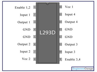

Step 2: Understand Arduino and L293D IC.
This step is for beginners who don't know much about arduino and motor drive IC. You can refer to thee Images provided to know the Pinouts of the board and L293D. Arduino is a microcontroller and L293D is a motor drive IC. Here the PWM (pin 11) of arduino is used to control the power for the actuator and pins 9 and 10 are used to control the directions. The code will be provided at the end of this post.
L293D is used to control the coils direction , an H-bridge is used as the coil cannot be connected to the Arduino directly. the direction pins 9 & 10 are connected to input 1 and 2 of the L293D. and PWM pin 11 is connected to enable 1.

Step 4: Making Connections:-
1. Place the L293 on breadboard and make connections as shown in the Diagram above. connect the Vcc to +ve and ground pins to -ve .
2. Connect the coil to output pins of the IC . (refer to the diagrams and pinouts.)
3. Connect Pin 11 of arduino to pin 1 (enable1) of L293D.
4. Connect Pins 9 and 10 of arduino to Input pins of the IC .
5. Connect arduino's 5v to +ve and Ground to -ve .
Thats all, Now next step is to write and upload the code.
