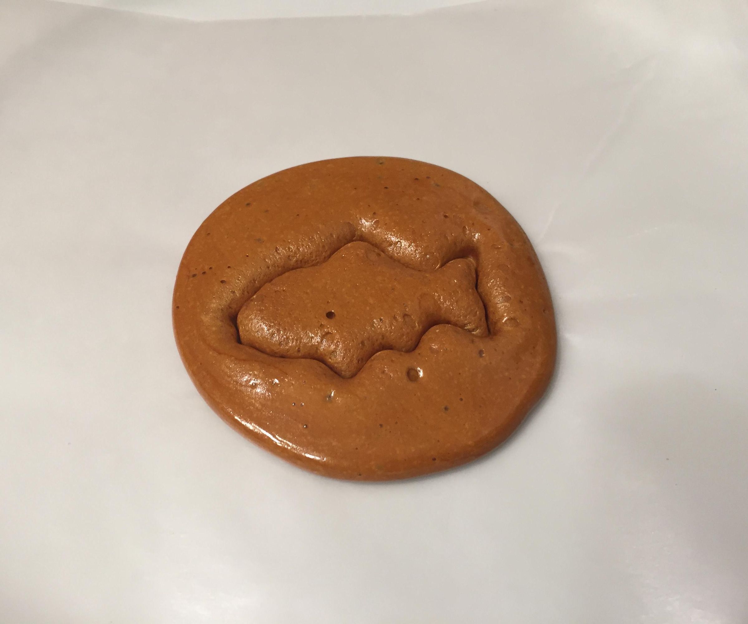

Step 4: Casting
1.       The casting material will be Oogoo which is GE Silicone 1 and corn starch. The ratio I used was approximately 1.5:1, cornstarch to silicone. Combine the two so that you get a consistent clay like substance. If it’s flaky and falls apart, add more silicone. If it’s still sticky, add a little corn starch. A little sticky substance is better than a flaky, crumbly mixture.
2.        Don’t play around with the Oogoo too much, or else it will set.
3.       When it is still soft, then place the mini screwdriver into the mould.
4.       Add the Oogoo on both halves of the moulds and firmly press fit the two halves together.
5.       Tape the moulds together and let cure.
6.       After two hours, remove the screwdriver from the mould and trim off any excess Oogoo.
Step 5: Final Product
