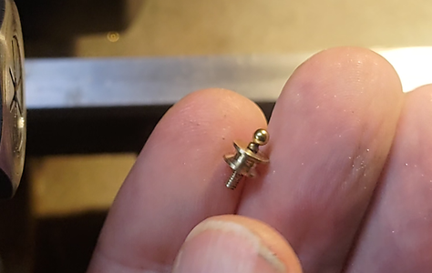

The video emphasizes the axle, and while it's certainly important, it's actually a simple part: just a short length of 0.35 mm steel spring wire. (Earlier versions of the design used a more complex axle, but this streamlined version works just as well.)
The critical component in this step is the hub.
There’s a groove that runs around the hub, and its depth should be carefully adjusted so that the diameter at the bottom of the groove measures exactly 4.34 mm. This value is calculated based on the 0.35 mm wire thickness, multiplied by 12.37, the number of times the Moon orbits the Earth in a year. This ratio ensures accurate relative motion in your model.
At one end of the hub, drill a 0.7 mm diameter hole 2 or 3 mm deep. This will hold the pin of the Sun.
At the opposite end, cut an M2 thread, which will be used to secure the hub into the pedestal.
The final thing to do in this step is to cut the pin of the earring to 2 mm, add a bit of superglue and insert it into the hole in the hub.

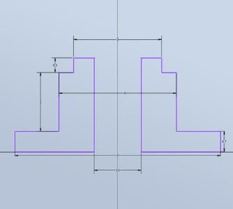

As the video shows, making the pedestal is straightforward. The image gives the dimensions, but they don’t need to be exact. The central hole is for an M2 thread. One thing not shown in the video: I deliberately made the 3 mm section a bit too short at first. Then, after assembling the parts, I tested if the ring could rotate freely. If it couldn’t, I slightly reduced the height of the 4 mm section (thereby making the 3mm section higher) until it did.

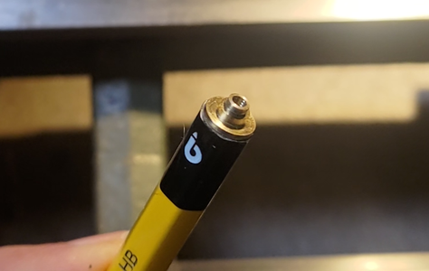

Then take a pencil and flatten the end and glue the pedestal on top using some super glue.

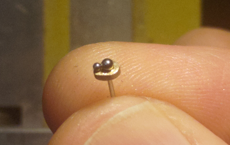

Step 4: The Earth-moon Egg
Start with a 4 mm brass rod and drill a 0.4 mm hole, 1 mm deep, right at the center. Next, use a ball endmill with a 1.5 mm radius to make a shallow indentation - this will hold the Earth.
Shape the tip of the rod into an egg-like form using a file. The widest part of this shape, where the Earth will sit, should be 2.5 mm across. The full height of the egg shape should be 3 mm.
At the top of this shape, make another small indentation with a 1 mm ball endmill. The center of this one should lie exactly at the edge of the egg shape, so it only forms half an impression. This will be the spot for the Moon.
Once you're happy with the shape, cut it off the rod so the egg is about 1mm thick.
Now glue a short piece of 0.35 mm steel spring wire into the drilled hole; it should sit snugly and not go all the way through. Then glue a 1.5 mm steel ball (the Earth) into the central indentation, and a 1 mm steel ball (the Moon) into the one at the edge. Carefully remove any excess glue.
Cut the steel wire, so that 6-7 mm remains
