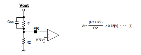

The image above explains exactly how the converter works. The operation of the output voltage regulation is essentially based on the choice of two resistors and a capacitor.
For example, based on the component datasheet, ROHM Semicon suggests:
For an output of 5V/500mA: R1=3.9kΩ R2=0.68kΩ and a of Csp = 0.1uF or 0.22uF
For an output of 12V/500mA: R1=7.5kΩ R2=0.51kΩ Csp = 0.1uF
Obviously, based on your needs, it is possible to calculate the appropriate resistances and CSP capacity to have the desired output voltage, based on the following formulas:
Vout = ((R1+R2)/R2)x0.75[V]
Csp = (4.7K/R1)x0.15
