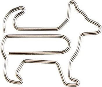

I used floral wire from the Dollar Tree and searched Google to find paperclip shapes, you can also search for silhouettes. While this shape has a nice outline, I only need the outline and would want the start and stop point to be around the foot, so it will stand on my base. Start by bending your metal around your outline to make your shape. You need to have an extra couple inches hanging down from your shape for the beginning and end. This will allow you to connect the alligator clips to the shape. (I find it helpful to print the image and bend wire on a flat surface.
