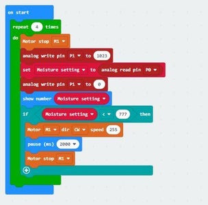

Step 2: Code Your Micro:bit
The code allows for an analogue reading to be taken between 0 and 1023. If the reading is below 777 (arbitrary moist soil limit) then the motor will turn on!
Once you have copied in the code, upload it to your micro:Bit and check that you can read the soil moisture and the pump turns on!
Watch the video link for further instruction on how the code works.
