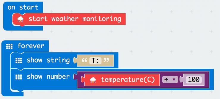

Step 5: Programming
- Drag and drop code elements until you get something that looks like the image below.
- You can also cheat and click on the "{ } JavaScript" button on the top and simply copy and paste the code in the code section below. Click on "Blocks" again to see the result.

Step 7: Code
Weather Station Code JavaScript
Simply copy and paste this code into the JavaScript editor in your browser.
basic.forever(() => {
basic.showString("T:")
basic.showNumber(weatherbit.temperature() / 100)
weatherbit.startWeatherMonitoring()
