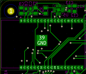

Step 2: The Brain of the Tiny Beast, the ESP32
Usually, when you create an electronic device that involves some kind of computational power, you need to select the right microcontroller that fits your requirements.
For this project, I've chosen the ESP32 Wrover E module. This module/microcontroller it's gives an excellent performance for emulation with two core at 240MHZ, 16MB of flash, 8MB of RAM, ultra low power co-processor, Wi-Fi and Bluetooth support, and full of peripherals and GPIOS.
Also, thanks to our friends of Espressif, it's very easy to implement in any design because you don't have to worry about adding external clocks, or a lot of decoupling capacitors. (They don't pay me for the advertisement)
If you're very interested in this module, here you can see the datasheet:
ESP32-Wrover-E datasheet
On the first image, you can see the schematics of the module of the board.
  • In the middle, we have the ESP32 module with connections to the peripherals.
  • On pin number 25 we have the IO0 pin. This pin selects the boot status of the device, in other words, if you can flash new firmware or start the already flashed one. If the signal is high will start the already flashed firmware, otherwise, with low, it will start boot mode and it will be waiting for new firmware.
  • Have look at pin 3, this the Enable Pin (AKA reset). Basically, if this pin is high the microcontroller will work otherwise no.
    • As you can see there is an RC circuit(Resistor/Capacitor). The work of this circuit is to avoid bouncing signals this means, we want clean signals when the board boot or it's flashed to avoid an unexpected reset. To be honest, this circuit is not totally necessary on this circuit because it doesn't have a reset button, but it's better to be cautious.
  • Pin 2 is IO2, and we attached a simple blue LED with a resistor. This LED works to show notifications, so no big deal with the part.
  • Finally, have a look at pin2 or VDD3V3. This is pin is to give power supply to the chip, to be exactly 3.3V, but it's important to notice the capacitors in parallel. These capacitors are decoupled capacitors and work to clean the power signal from parasite interference. If you don't add these capacitors probably it will work the device, but it's a recommendation of the manufacturer, and probably they will know more than us.
On the last three photos, it's shown the PCB design layout and the real PCB with the part that we're studying in focus.
The last tip that can be useful, the components that are related between them must be has near as possible.

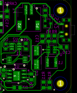

Step 4: A Portable Device Is Not Portable Without Battery. Power Management
This is probably the most complex part of this project in terms of electrical design. To simplify the explanation, we are going to split this point into three parts:
  • Battery charge and protection circuit.
  • Power supply management.
  • Battery level control.
Battery charge and protection circuit (Schematics 1, block 1 of the PCB photo):
With Li-Po batteries, safety first, because they can be very dangerous with inappropriate use. So, we need to do a correct charging with constant current and control we don't charge over the 4.2V or discharge the battery under 2.8v to avoid damages to the battery.
We will start with the TP4056. This integrated circuit is a Li-Po battery charger, which provides constant linear voltage-current. One of the most interesting features is that you can set the charging current modifying the value of the resistor R2. Remember that the charging current should be around 25% battery capacity. This integrated circuit is connected to the LED D1, to show the charging status of the battery.
Then we go to the FS312F-G. This IC is a battery protection circuit, which "cut" the usage of the battery if detects overcharge or over-discharge on the battery. This will avoid damages to the battery.
Finally, we have FS8205. This is an IC that integrates two MOSFET transistors, to select the power of the circuit. I mean, if the battery is on a good range, it will get the energy from the battery, otherwise, if we connect the device to the USB port, it will work directly with the energy of the USB.

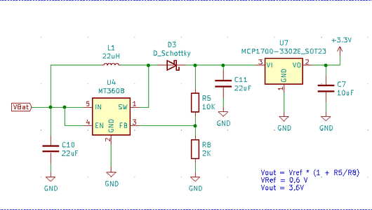

Power supply management(Schematics 2, block 2 of the PCB photo):
This block is a step-up with a voltage converter to provide a constant voltage of 3.3V. The Li-Po battery has an operative voltage of 4.2v at the maximum charge and 2.8v at the minimum safe voltage. So, we need to provide constant voltage to avoid instability with the microcontroller or brightness decrease on the display. To solve this issue, we use the MT3608, which is a configurable step-up voltage converter. At the output of this circuit, we will have always 4.2V. This is too much for the logic level of the device, which works with 3.3V, so we use the MCP1700 voltage converter. This integrated circuit transforms the voltage from 4.2v to 3.3v. The problem is solved!
I know that this is a little over-engineer or maybe inefficient solution because there are step-up/step-down solutions that will simplify a lot the circuit, but this was the cheapest solution, and the result is good.
Battery level control(Schematics 3, block 3 of the PCB photo):
As simple as a voltage divider before the step-up circuit. We know that the voltage at this point will be at the maximum point 4.2v, so it's just necessary to calculate a divider that drops to 3.3v to respect the logic level of the ESP32 and connect it to an ADC GPIO to measure the analog level of the signal.

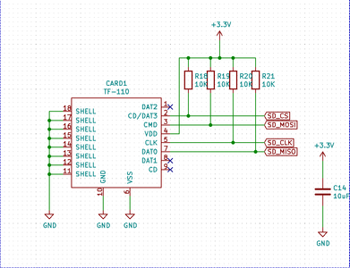

Step 5: The Place Where the Games Lives, the SD Card
This module is pretty simple. The SD card work with SPI protocol, this a bidirectional communication that allows high-speed communications. With peripheral, you don't have to worry about crosstalk because it's not enough speed to create a magnetic field(Or at least I didn't have any problem)
The circuit is pretty simple, connect each line to the SPI GPIO of the MCU and add a pull-up resistor. This resistor is important to maintain a constant high level on the line and avoid middle-level signals which can corrupt the data transaction.
And also our old friend the decoupling capacitor.

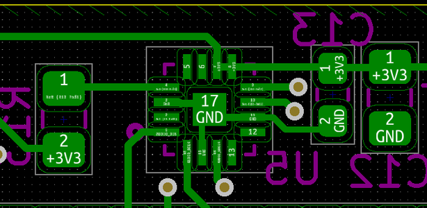

Step 6: Games Without Sound Is Very Boring
With the ESP32 we have two different options to output audio. If we check the datasheet, we can use the integrated I2S to DAC converter or directly the I2S peripheral.
The simplest way to obtain an audio output is to use the I2S to DAC converter because you can directly connect a speaker to the GPIO and if you think that the audio volume is low, you can always use an analog audio amplifier, which is pretty easy to implement. But this solution has inconvenient, the DAC only uses 8bits of the 16bits that provide the I2S. This means, we will lose a lot of audio information, which translates into very poor audio quality.
So, let's have a look over to the I2S output. The I2S is a digital audio protocol that warranty high fidelity audio without any significant loss of quality or noise introduction. The issue is that we require a converter analog converter and amplifier to hear something.
No problem, we have our popular and expensive friend the MAX98357 audio amplifier. This driver transforms the I2S signal to analog and amplifies it to directly use on a speaker or headphone. This amplifier/converter give us 6.4w of output power, with configurable output selection, this means, you can choose between mono or stereo audio, and select the impedance.
Finally, we connect the output to the speaker, and voila! We have sound!

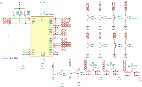

Step 7: Add Some Buttons, Please
The ESP32 is a nice module, but it has a very little quantity of GPIO ports. But don't worry we have the solution, the TCA9555.
The TCA9555 is an I2C GPIO multiplexer. This device allows the use of up to 18 extra GPIO. These GPIOs can be used as input or output and can be controlled or check via I2C. So, with just using two GPIO (I2C SDA and I2C SCLK) you have 18 extra GPIO! The delay is not a problem because you can read or write up to 400Khz, which means 400000 times per second!
Let's have a look at the schematics. This multiplexer works with I2C as we already said, so we need to pull-up each signal to avoid noise on the line. It also has an interruption pin, but it's not used. The I2C signals are SCL and SDA pins(19 and 20). On the other hand, you need to configure via hardware the direction of the device, this configuration is done by setting the logic level of the pins A0, A1, and A2. We only have one I2C device, so, we will give the direction 0x00.
Finally, all the switch buttons are connected directly to the integrated circuit, the reason is we set the pull-up or pull-down resistor through the software configuration because this multiplexer has a configurable internal resistor.
One of the interesting points of this device is the inductive buttons, these are PCB routes that didn't have silkscreen so, with a rubber button with carbon film you can use it as a switch button. This is a regular method on any gamepad. If you want to use on your design, you can find on the libraries attached to the project. (I know that it's difficult to find a library of inductive buttons)

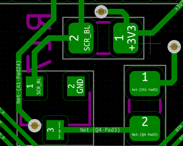

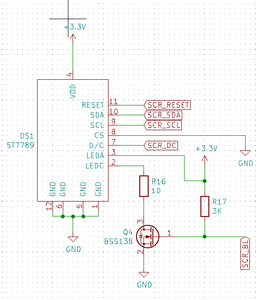

Step 8: To Enjoy It, We Need a Nice Display
The display is an IPS 1.3" screen with a resolution of 240x240px which gives very nice colors and sharp images. The communication protocol is SPI, this allows to achieve a frame rate of up to 70FPS (At least it says the datasheet). I won't very deeply with the display because basically, the manufacturer doesn't recommend using any kind of pull-up resistor or decoupler capacitor, I leave it as it's.
On the other hand, the backlight of the display can be controlled to select a brightness level. To do so, we will control the current of the LED embedded on the display, this control will be done with a BS138 MOSFET transistor.
