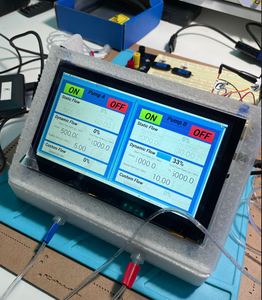

The present project aims to improve the design of the PiFlow system by designing a graphical user interface to be displayed on an LCD touch screen display to adjust flow rate parameters easily. Specifically, the interface will allow the user to select between three different modes. The static flow mode will allow setting a constant flow rate (uL/Min) to be executed for a pre-defined flow time (Sec). The dynamic flow mode will allow the user to select a range of flow rate values where the system will linearly adjust the pumping rate (uL/Min) following a pre-defined sweep rate (uL/Min) adjustable through the interface. Lastly, for applications requiring higher complexity, a custom mode will allow the upload of a CSV file containing a list of flow rate parameters to be executed by the system. The underlying code of the interface will be made available for modification and improvement on the Github Project Page. Overall, the interface serves as a first design iteration utilizable in various microfluidic open source systems.

Step 4: Calibration & Testing
The calibration of the pumps was executed according to the procedures reported in the PiFlow project. The following features of the interface were tested as demonstrated in the videos provided:
- Selectable flow mode between static, dynamic, or custom.
- A pop-up warning message when out-of-range flow rate values are entered.
- A pop-up warning message when more than one flow mode is selected.
- A pop-up informative message when pumping execution is completed.
- Progress bar dynamically evolving to report pumping progress.
- OFF button allowing to reset the progress bar after execution.
